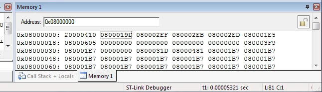

I'm trying to create a bootloader into the component STM32f106RDT with 384KO of Flash.
I have mapped the memory like this:
0x08000000 - 0x0802DFFF for main software (first binary)
0x0802F000 - 0x08030FFF reserved
0x08031000 - 0x0805FFFF for the temp binary (second binary)
My function of bootloader() to jump at selected main address is in flash.

The problem is that i want to jump on one of the two binary file. How do i get the flash address of the main() function? If i jump on 0x08000000+4 the beginning of the first binary mapping it does nothing.
Somebody have an idea to select one of my 2 apps and run it?

Posted on April 03, 2014 at 18:11
Presuming your secondary code is built with it's own vector table.
 LDR R0,=0x08031000 /* Or 0x0800000 for the base image */
 LDR R0, [R0, #4] /* Vector+4 for PC */
 BX R0
Plucking out arbitrary functions/addresses within another image is a hazardous task. Remember also that 16-bit THUMB code has ODD addresses, and the M3/M4 cannot run 32-bit ARM code.

Posted on April 04, 2014 at 09:17
My next function is going in hardfault handler, why?
void FLASH_Bootloader(void)
  __disable_irq();
  JumpAddress = (uint32_t) (void *)0x08000004;
  Jump_To_Application = (pFunction) JumpAddress;
  /* Initialize user application's Stack Pointer */
  __set_MSP(*(__IO uint32_t*) 0x08000000);
      __enable_irq();
  Jump_To_Application();

Posted on April 04, 2014 at 10:00
Hi
Why enable Interrupts before doing the jump?
I suspect this may be causing the Hardfault - the stack has just been changed and now any IRQ can trigger, which may try to do a context switch on an empty stack

Posted on April 04, 2014 at 10:17
Hi
''By ODD address, do you mean
JumpAddress = (uint32_t) (void *)0x08000004+1;''
I have never really understood clive1's comments about jumping to an odd address.
What you are trying to do is to emulate the boot up process.
The boot process has a pre-determined address to go to (this may be fixed or may be configurable, lets just say it is fixed for now). Lets call this the 'boot vector'
The boot up process takes the first address at the 'boot vector' as the address for the stack.
The next address along at the 'boot vector' is the address of the code to run.
When you compile and link some code on the ARM, usually the linker script will place the vector table first. The first 2 entries in the vector table are : the address for the stack and then the address for the code to run.
So your code should look like this :
  __disable_irq();
  JumpAddress = (uint32_t) (void *) <address of new binary + 4>;
  __set_MSP(*(__IO uint32_t*) <address of new binary>;
where <address of new binary> should be 0x08031000
(Check if this address is valid for placing the vector table - see the reference manual for NVIC)

Look, you're not trying to jump to 0x08000004 but the content pointed TOO by it, indirectly.
You also don't want to be jumping to the main() function because it would ignore all the C runtime startup code which copies your statics, and clears your initial variables.
Observe the ODD address of the code that is supposed to get jumped too.
