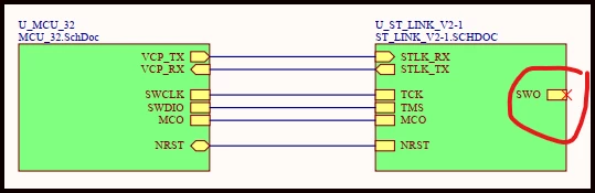

I have a STM32L432 Nucleo-32 board and I'm trying to use ITM printf trace.
I created new project with configuration: "Targeted Project type: Empty" "targeted language: C++". I'm not using HAL libraries.

I don't see any traces in the SWV ITM Data Console window. Any ideas why? What am I doing wrong?
Best answer by DPiór.1
Looking at the Nucleo board's schematics I found out that ST-Link is not connected to MCU's SWO. Hence using ITM printf trace is not possible.

I don't think it is because the MCU has too few pins, because SWO is available on pin PB3.

On sheet 1 I can see that SWDIO of the target is connected to TMS of the ST-Link.
On sheet 3, TMS is connected to T_JTMS, with the net labelled as "TMS/SWDIO".
All posts are made in a personal capacity. MISRA C++ Chair, MISRA C WG Member, Director The MISRA Consortium Limited (TMCL)
Andrew Neil
May 30, 2025
@CTapp.1 wrote:
I though that's what it used to program the target device?
SWDIO & SWCLK are used for programming and debugging.
But this thread is about using the ITM Trace output, which goes via SWO - an extra pin!
