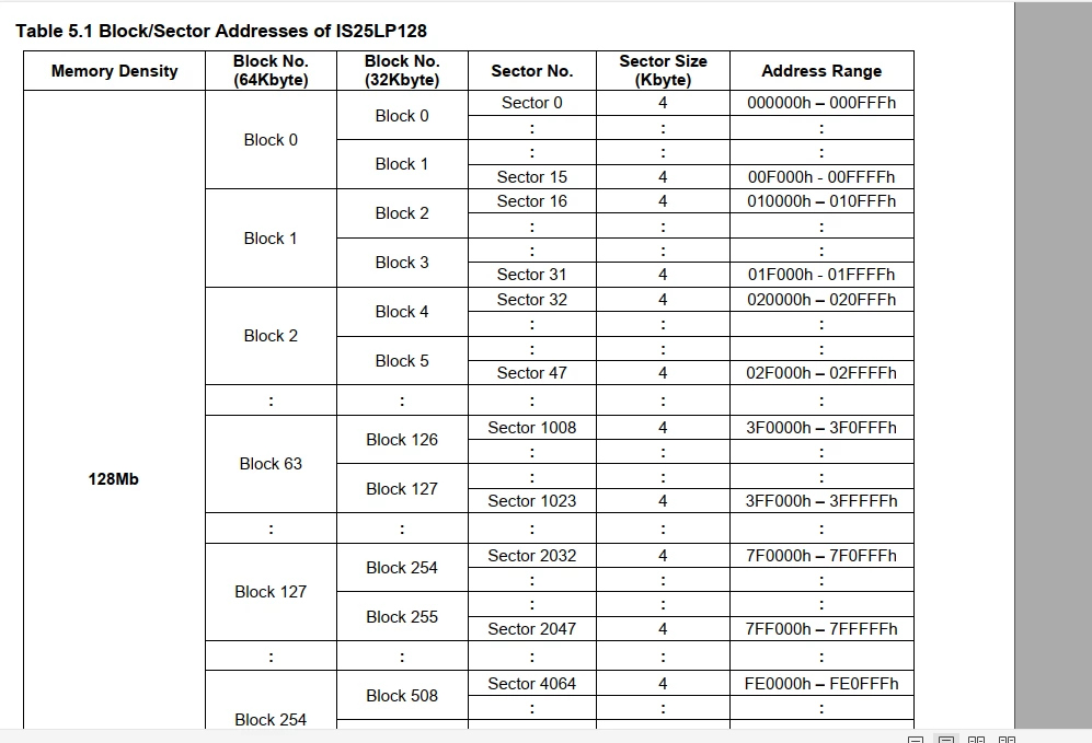

Jun 9, 2022 1:14 PM UTC
0693W00000NrWPzQAN.pngthe above is the memory mapping of the device.
sector size = 4096
number of secotor = 4096

Tesla DeLorean
Guru
Jun 9, 2022 1:49 PM UTC
Ok, but like I said, these things have to work flawlessly.
You should test them thoroughly outside of the MSC context, and provide telemetry about the usage by the MSC, including perhaps details of the blocks and CRCs for the data inside, so you can walk logged output and understand why it wants to reformat from one usage to the next. The primary cause for Windows to want to reformat is that you're not giving it the data it expects, or wrote into blocks/structures it did the last time it was formatted.
I'm not looking to walk code for bugs, you'll need to instrument this and validate/debug it yourself.

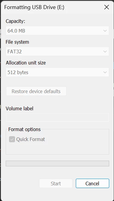

Jun 24, 2024 2:31 PM UTC
Hello @ykn & @Tesla DeLorean ,
                                                        I have been following this thread to replicate this in my controller. however i got struct at formatting the disk after detecting in windows. while debugging i noticed Read is getting called and while formatting in windows write is getting called. if i start formatting in windows after certain time it is getting failed. No matter what i did, not able to move forward. Is there any thing i am missing here. Kindly guide me here.
