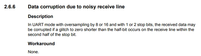

Hello @FilipF303RE ,
This could be related to a known limitation where data corruption can occur due to a noisy receive line.
This limitation is described as follows:
As mentioned in the limitation description, the issue happens when the glitch to zero has a duration less than a half bit duration and arrives during the second half of the stop bit.
Feb 8, 2025 2:16 PM UTC

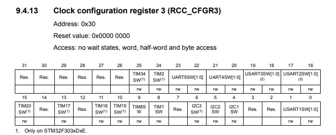

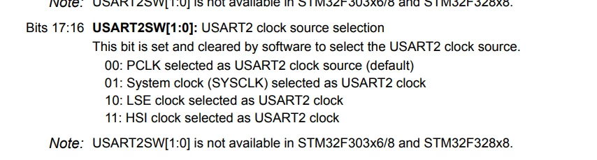

Hello @Tesla DeLorean,  The project is built from scratch—the only thing implemented is the CMSIS register libraries, so apart from that, I have nothing else. According to the reference manual, the default clock frequency for usart is from APB1. Would it be possible to check the baud rate via SWO? i left u here photos thats showsh from which bus frequency is coming from.

It's not running at 72 MHz
If you leave the RCC alone the chip will clock at 8 MHz via HSI,and busses at DIV1
SWO should work at 8 MHz
