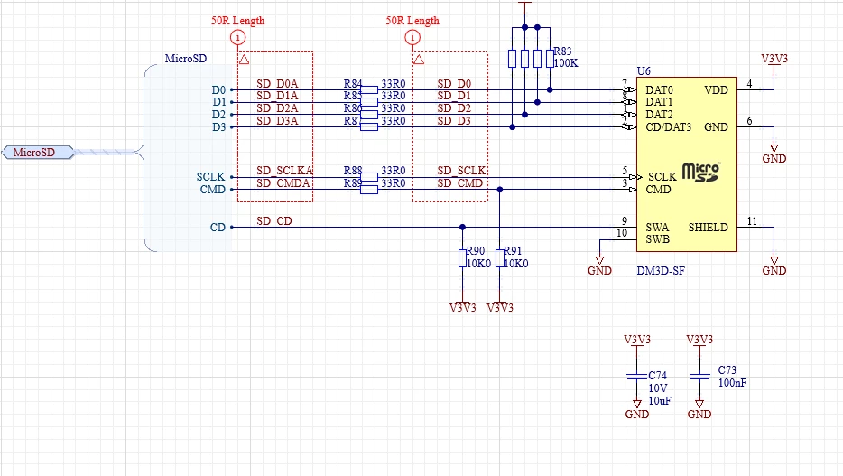

I am trying to configure my STM32H743ZI2 to work with a microSD card. For data logging purposes.
schematic of the SD card adaptor:0693W00000AMlhCQAT.pngI configured the following in CUBEMX:

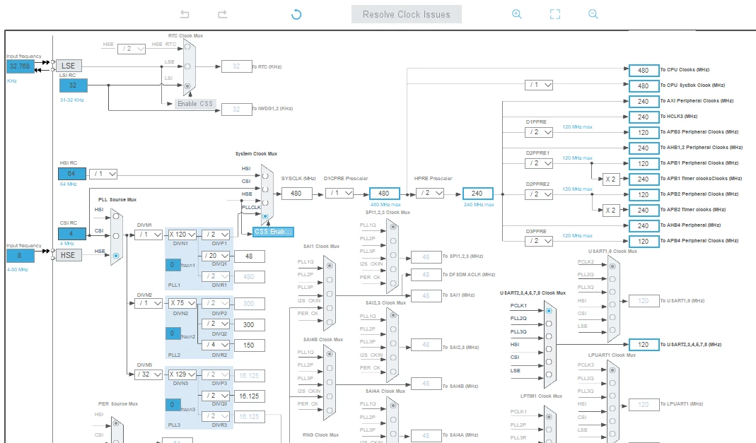

SDMMC1 as SD 4 bits Wide bus with SDMMC1 global interrupt enabled (all other settings are default)
FATFS mode SD Card with everything default.
Changed stack and heap size : 0x400 heap size, 0x800 stack size.
My clock config:0693W00000AMlmkQAD.pngWhen i run the following code :

When i test the signal on the oscilloscope i notice that:
From the start of the f_mkfs function the CLK is always 400KHz, even if i change the clockvalues
CD responds with short HIGH signal.
All data busses are completely empty, (no data)
I added a zip file of my fully configured SD test program.

set port pin pullups and speed to medium ;
