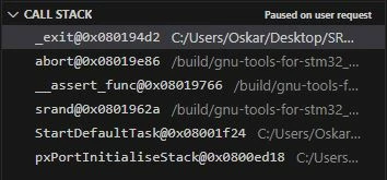

Whenever I call the srand() function, my code immediately ends up in the exit handler.

  • Project with lwIP and FreeRTOS -> srand(12345) causes an exit.
I’ve attached an image showing the callstack where the issue occurs. I hope this helps in diagnosing the problem.

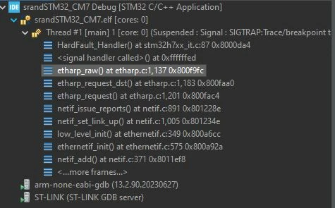

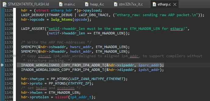

I call the srand() function in the main.c file of the CM7, specifically at line 362.
I tried building the project using Cube IDE with the same .ioc file. With this setup, the srand() function works, but I encounter a hard fault, as shown in the attached images.

Running your example with CubeIDE I got that hardfault but nothing related to srand() call. The hardfault is caused by  MX_SDMMC1_SD_Init() and may be the subsequent calls.
I commented out these lines and no more hardfalt occured again:
MX_SDMMC1_SD_Init();
MX_USB_OTG_HS_PCD_Init();
MX_FATFS_Init();

__assert_func should (try to) write soemthing to stderr. You may catch the output by setting a breakpoint in your/default _write syscall implementation.
my guess:
NOTES
<<rand>> and <<srand>> are unsafe for multi-threaded applications.
<<rand_r>> is thread-safe and should be used instead.
PS: Does ST provide easily obtainable (and buildable) official libc sources to reproduce such potential libc issues?
I use GitHub - bminor/newlib: Unofficial mirror of sourceware newlib repository. Updated daily. which should be close.
