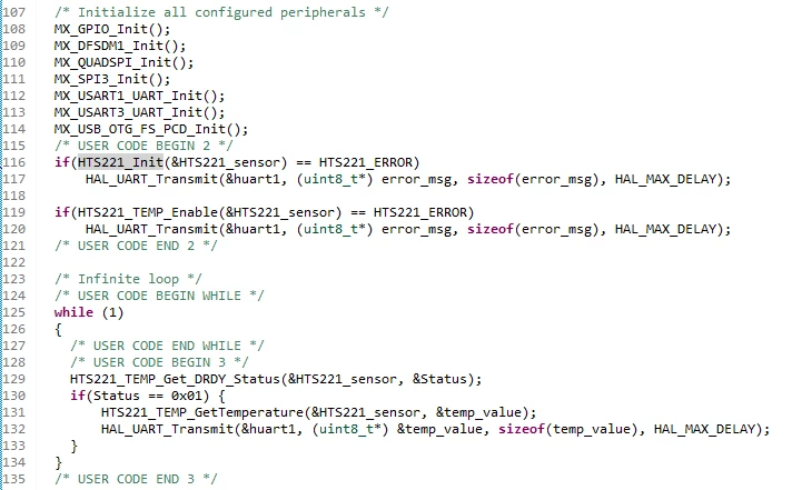

Hi ST Community,
I'm using the B-L475E-IOT01A card and I have a problem. As soon as I run my code in Debug mode, I get the HardFault Handler (SIGTRAP) error. I want to use the HTS221 temperature sensor and I'm using the BSP for this sensor (hts211.h). This error appears when the function enters HTS221_init -> HTS221_Initialize -> hts221_power_on_set -> hts221_read_reg -> ctx->read_reg which are in the hts221.c and hts221_reg.c files.
Here's my code and the variable declaration:
(I'm stuck line 116)
Thank you in advance for your help.
1 reply
January 9, 2024
Little update: The problem is that the i2c bus isn't initialised. But i have still one question: Do I have to create the "HTS221_IO_t" structure myself? Define each of its characteristics?
"typedef struct
HTS221_Init_Func Init;
HTS221_DeInit_Func DeInit;
uint32_t BusType; /*0 means I2C, 1 means SPI-3-Wires */
uint8_t Address;
HTS221_WriteReg_Func WriteReg;
HTS221_ReadReg_Func ReadReg;
HTS221_GetTick_Func GetTick;
HTS221_Delay_Func Delay;
} HTS221_IO_t;"
(My goal is to use this function: "HTS221_RegisterBusIO(HTS221_Object_t *pObj, HTS221_IO_t *pIO)")
