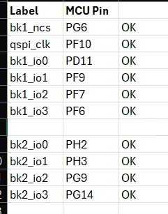

More info: the pin config in the ioc file has been setup as follows (existing code in the ioc file is setup as a single bank config, but both chips are soldered on and the CS is shared). The board also has a push button latching circuit, so that code is also included in the main.c file. The QSPI clock input frequency is 90 MHz and the prescaler is 1, so my understanding is that it's running at 45 MHz. I have not yet tried generating the stldr file; if my code fails this test I assume that it'd fail there as well, and I would like to understand exactly where I'm making a mistake for the sake of personal learning. The provided code also seemed to repeat the reset block three times; I' don't understand the reason for this, since the datasheet simply states that the requirement is to wait for a certain number of microseconds.
