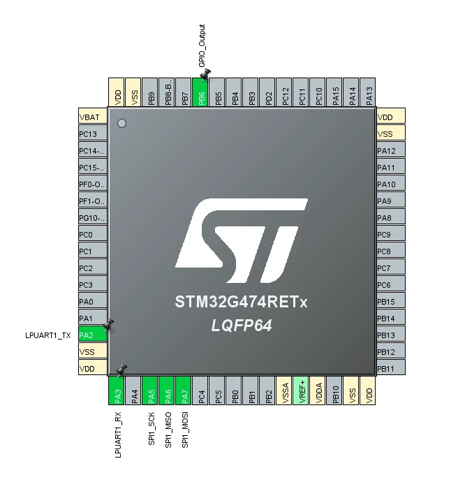

HI All,
I have created a project to integrate sd card with STM32G474RE nucleo board while using SPI interface. After running the project I am able to initialize the sd card properly but while mounting the sd card, I am getting one error like: "FR_DISK_ERR".
I am usung STMCubeide to do the configuration and followed some tutorial to setup my fatfs library.
I am attatching my project here for the reference.
Please have a look on it and help me rectify the issue.

I have gone through the example project. I am using SPI instead of SDIO for my project but I followed the same process:
1) MX_FATFS_Init
2) SD card initialization
3) f_mount
and I am facing issue in the last step and getting error FR_DISK_ERR

Thanks for the suggestions. I am able to perform read and write operations properly.
To be more precise changing "MAX_SS =512" worked for me and other changes are good to have for executing application in efficient way.
