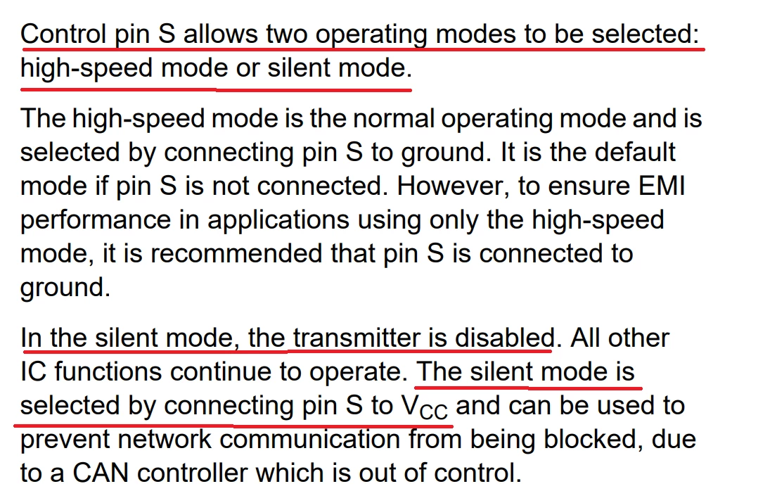

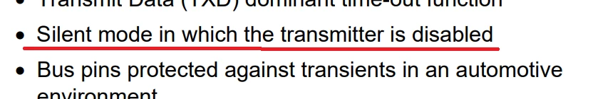

The TJA1050 is a 5V transceiver but VIHmin = 2V which is OK.
Meanwhile, what do you set as voltage level for S pin (Silent mode)?
So check if S pin in connected to the ground.
