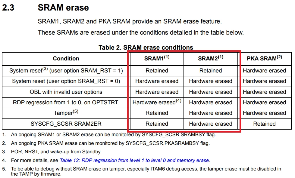

From performance/architectural point of view there is no constraint to use them as the same block (if SRAM1 = 32kB):
But you need to take care about some specificities of the security feature of each SRAM block:

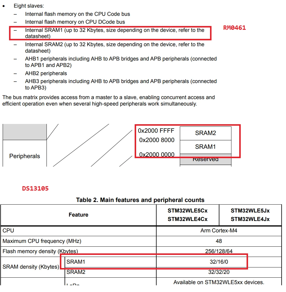

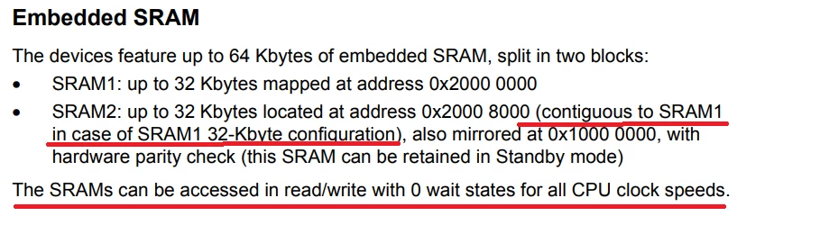

It depends on your device. You need to check if your device has 32kB for SRAM1
According to RM0461 & DS13105:
So if SRAM1 size is 32kB this means SRAM1 and SRAM2 are contiguous and you can assume the two RAMs as a same block. If not, you can't combine them.

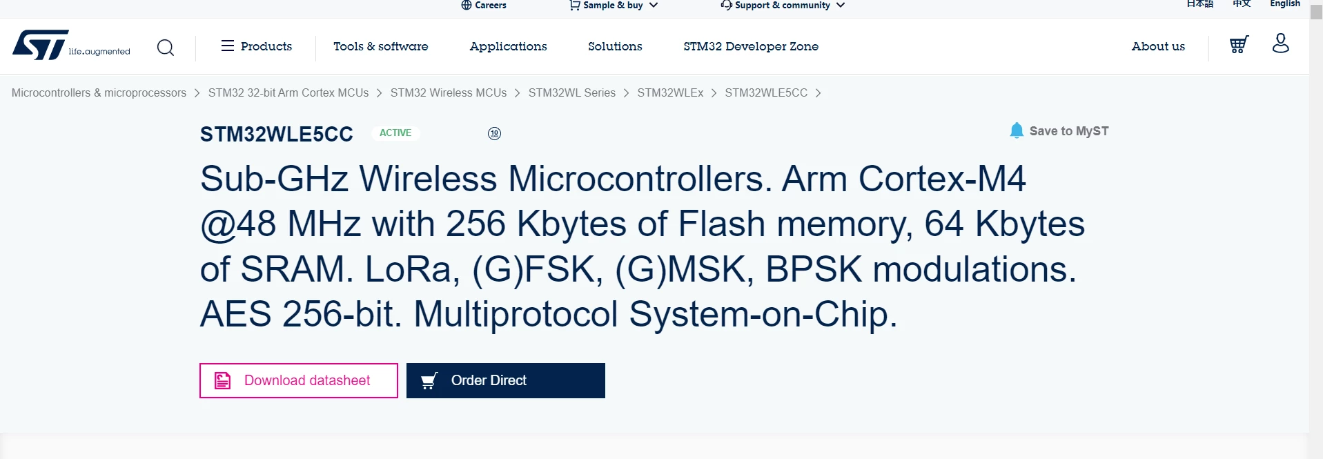

I will be attaching the STM 32 based microcontroller(STM32WLE5CC) which i am using with the link -
-  https://www.st.com/en/microcontrollers-microprocessors/stm32wle5cc.html
