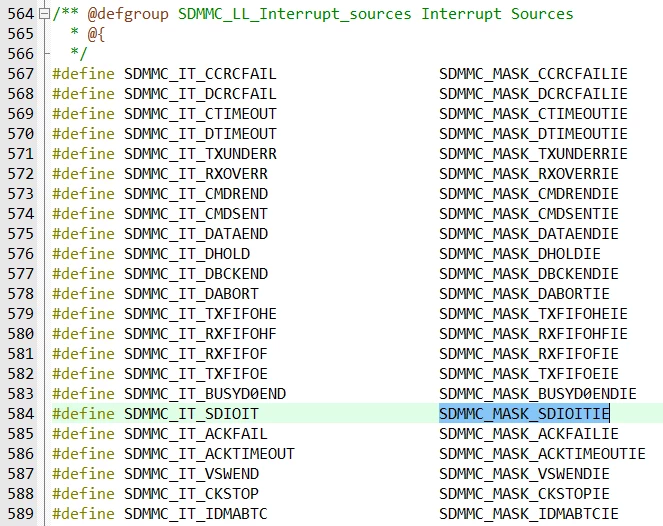

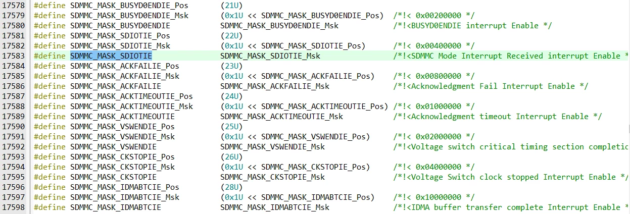

This issue is already fixed in the STM32CubeH7 v1.4.0 as follow :
in the stm32h7xx_ll_sdmmc.h:
#define SDMMC_IT_SDIOIT SDMMC_MASK_SDIOITIE
In the stm32h743xx.h :
#define SDMMC_MASK_SDIOITIE SDMMC_MASK_SDIOITIE_Msk /*!<SDMMC Mode Interrupt Received interrupt Enable */
Regards,
Imen.
