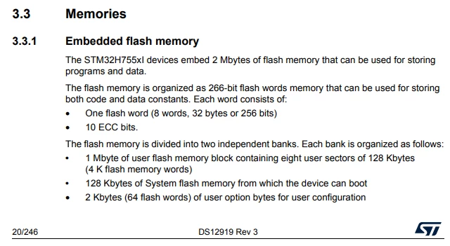

Andrew Neil
Jul 29, 2026 10:53 UTC
The 2nd worst is probably that they have only 1 flash bank (at least the H723 .. H735 that I used),
It seems that ​@Domy_ST is using STM32H755ZI ?
That one does have dual banks:
https://www.st.com/resource/en/datasheet/stm32h755zi.pdf#page=20
