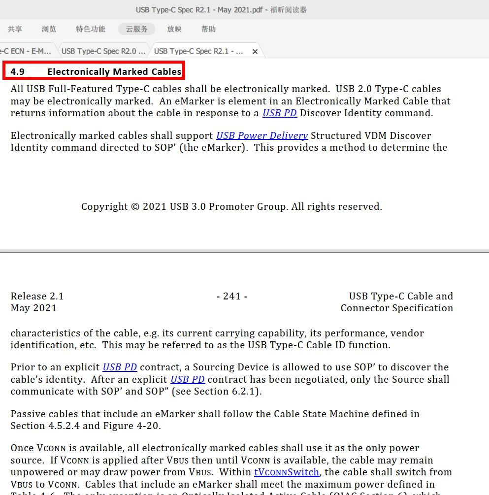

Is there any source code about e-mark cable?
I didn't find any information about e-mark cable in the link below, Have ST developed the code for the e-mark cable?

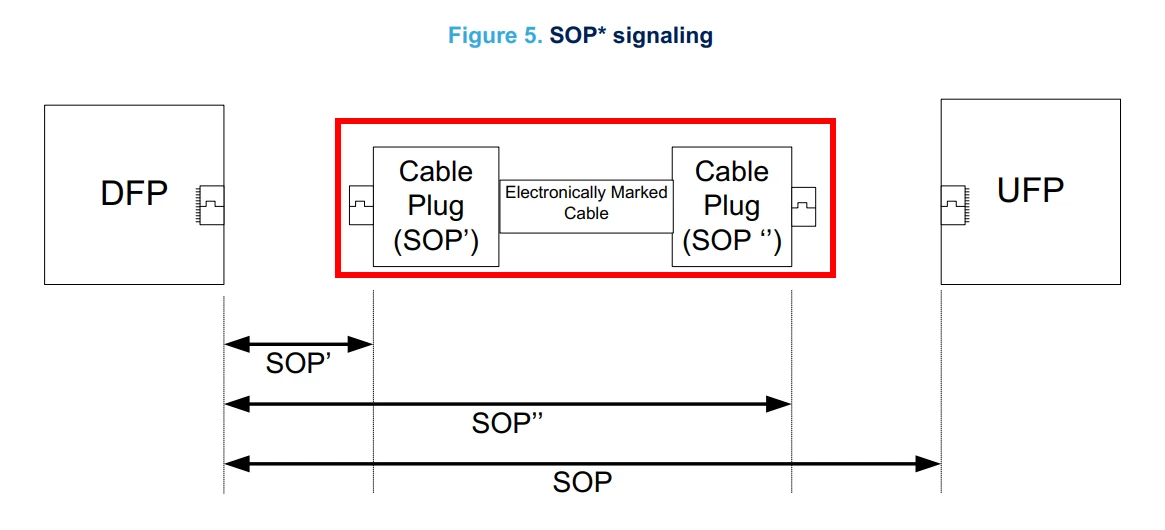

Yes, Emark communicates with the host via SOP‘.
