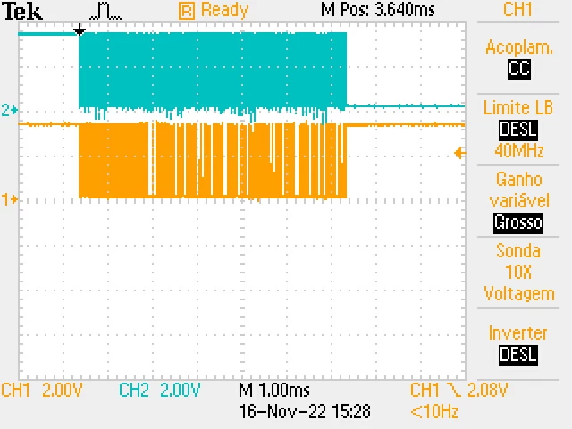

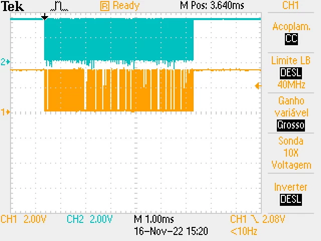

Nov 16, 2022 8:02 PM UTC
in my case I am using an I2C FRAM (https://www.fujitsu.com/uk/Images/MB85RC256V-20171207.pdf). This slave has no page boundary.
Furthermore, I have a known pattern written and I can read everything correctly. I believe that the problem is with the master that does not release the clock after the communication when I perform readings of more bytes.
look osciloscope images below (I´m sorry .. I dont have a logic analizer)
OK (Blue is Clock .. it goes high after communication)
FAIL (Blue is Clock .. it goes low forever and I2C stops)
I only change the bytes to read using HAL_I2C_Mem_Read_DMA().
