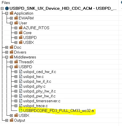

It looks like a link problem. Undefined symbols as USBPD_PE_Init, are expected to be present in the USBPD Core library.
Please check that you have such lib in the objects of your project : below picture is an example of USBPD MW lib in case of IAR Ewarm project.
_legacyfs_online_stmicro_images_0693W00000biUp5QAE.pngRegards

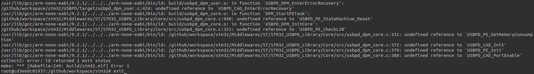

Thank you @Guenael Cadier​ for your help,
I checked the example and I followed this tutorial to set up my usbpd sink device:
https://youtu.be/-vsJhNIaHxE
However after code generation i cannot build the project.
I am using STM32U575-Nucleo board, building it with the cubemx generated Makefile.
I get the following errors:
_legacyfs_online_stmicro_images_0693W00000biUYjQAM.pngI don't find definitions for these functions, only declarations in the header files.
Can you help me where I messed up? :)

Hi @MCseh.377​
