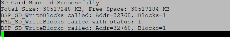

Current Issue Summary:
I can successfully mount the 32GB SDHC FAT32 card and read the capacity using FatFs.
However, f_write always fails.
After debugging, I found that BSP_SD_WriteBlocks fails when writing to LBA 32768.
I also verified this with direct HAL_SD_WriteBlocks, which fails at LBA 32768 but works on lower LBAs like 0 or 1.
This suggests the problem is not in FatFs logic, but rather in high LBA (large address) block access stability.
