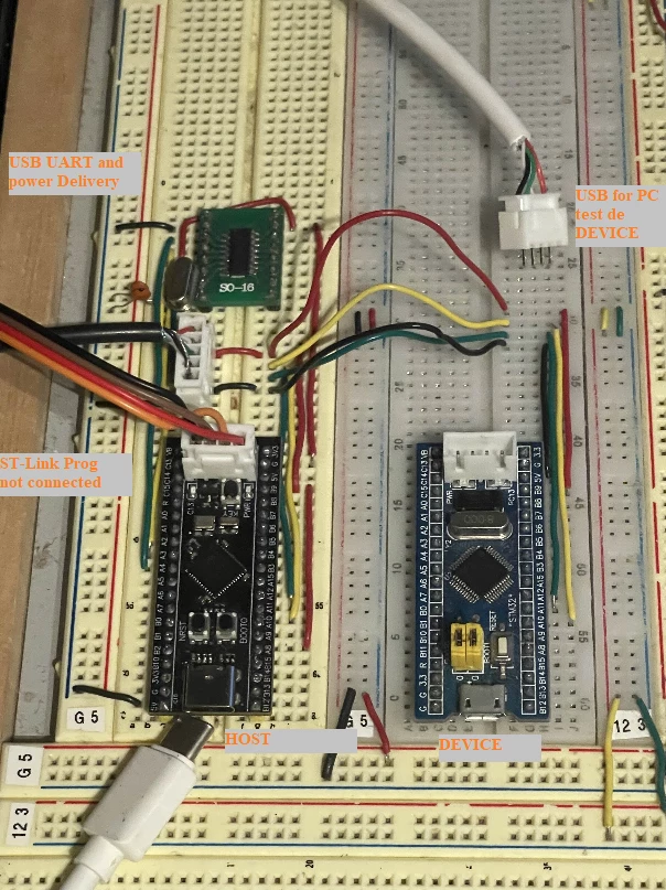

Now, before I buy a Nucleo-F411RE, is it capable of handling HOST/CDC? I tried a Bluepill (DEVICE) and a Blackpill (HOST), but nothing happened... The DEVICE mode works great. I even tried using the Blackpill in device mode, and that worked fine. The UART part works too... It’s just the HOST.
I don’t want to waste money if I’m just going to end up back at square one. Plus, I might as well switch to the ESP32... but yuck, their suite is Python-based. I’d rather stick with STM32CubeIDE.

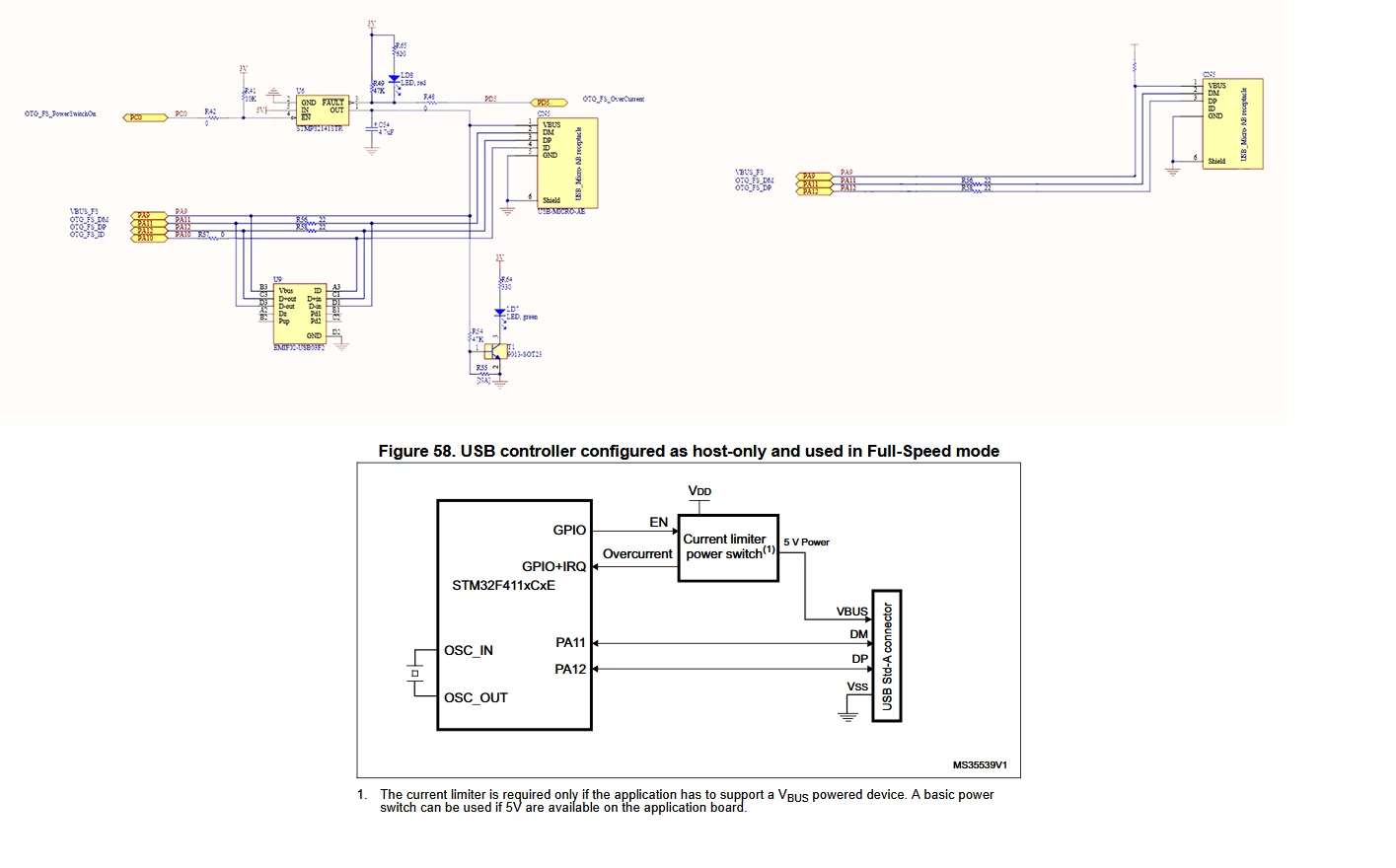

As for buying Nucleo-F411RE - the board picture shows no user USB port at all, not device neither host.
So you’ll have to add the host connector, provide the USB power supply, with overcurrent protection and so on. Good news is that “OTG” specific signals can be ignored because you want just the host function.

Yes, I had already seen this in the documentation. (OK, English isn't my native language, so it takes me a few readings to understand it.) And if I understand correctly... D+, D-, VBUS, GND… that’s all we need… I even tried temporarily replacing the switch by plugging it into the 5V line with a resistor, but nothing happened… maybe my setup isn’t right… I find this frustrating, because usually STM code is pretty straightforward. The example online doesn’t seem that special to me.

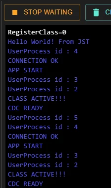

In every case never the host trig  APPLICATION_READY.

> So I looked over the code in the example, but I couldn't find any references to PD5.
I had just noticed this pin was routed to the target USB interface of the Disco board, but did not dig deeper.
Digging deeper, it is connected to the /FAULT output of the STMPS2141, and thus not directly associated with the USB peripheral. You could use any free GPIO in your application here, I think.
The same goes for PC0 as an enable input (/EN) for the STMPS2141.

It started working. Now, even though the USB interrupt is enabled, I’m not getting any USBH_CDC_RxCpltCallback callbacks. So I’m going to close this thread and continue on the other one after my workday.
