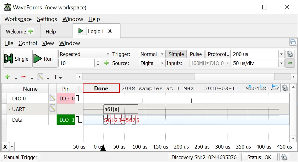

Here is an example with UART@115200 Cortex-M0@48MHz:
The UART 'a' is measured on the wire. The falling edge of DIO0 is triggered in the first line of USART2_IRQHandler(), the rising edge of DIO0 is triggered in the first line of HAL_UART_RxCpltCallback() which is even before the call to the next HAL_UART_Receive_IT(). No chance, you will loose char's.
But, DMA works quite nice. I have seen circular RX DMA beeing used without any callback but as a ring buffer with polling __HAL_DMA_GET_COUNTER(huart->hdmarx) in the main loop: https://github.com/yoneken/rosserial_stm32/blob/master/src/ros_lib/STM32Hardware.h
Sure, for water-tight error handling, some more efforts are required.
Mark81
Mar 12, 2020 5:22 AM UTC
Just to be sure:
> The rising edge of DIO0 is triggered in the first line of USART2_IRQHandler(), the falling edge of DIO0 is triggered in the first line of HAL_UART_RxCpltCallback()
Did you swap rising/falling, didn't you?
KnarfB
Mar 12, 2020 6:28 AM UTC
I did, thanks, edited.
