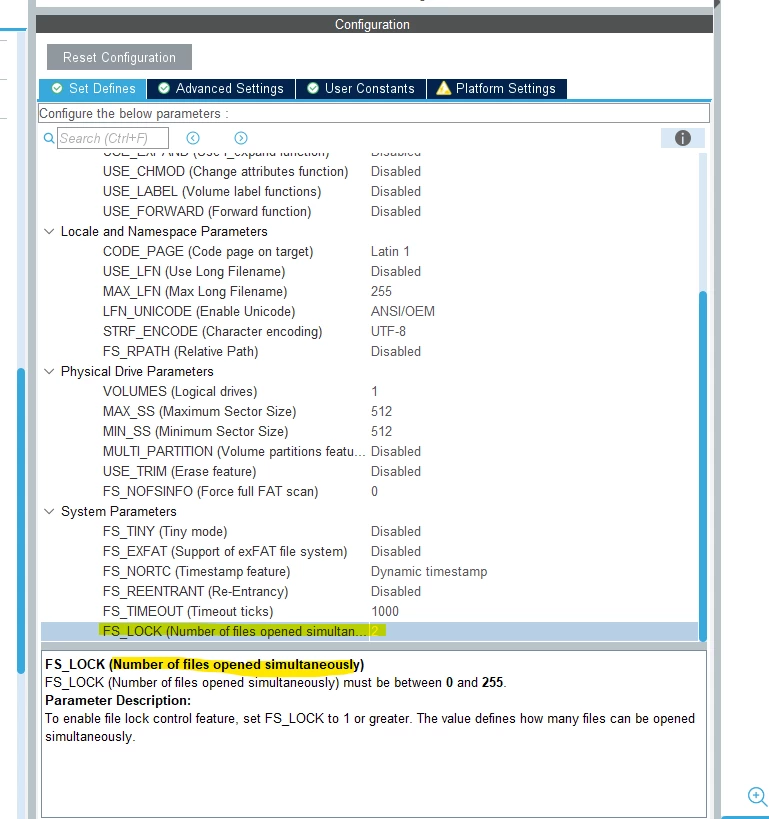

Hello @MauFanGilaMedical
Yes, it is possible to open multiple files simultaneously using FATFS. The number of files can be set via the FS_LOCK parameter in STM32CubeMX.

so I can open one file in uSD and copy its content to another on uSD ?
I have to do this copy to change some content.
I did a first try but processor goes into Hard_Fault ... I supposed that I cannot open two files.
I will investigate and Accept as Solution if I see that I can.
Thankyou for the advice

I would think separate FIL objects for both files should suffice.
Otherwise, I would try to call f_sync() whenever you change the file you currently access.
