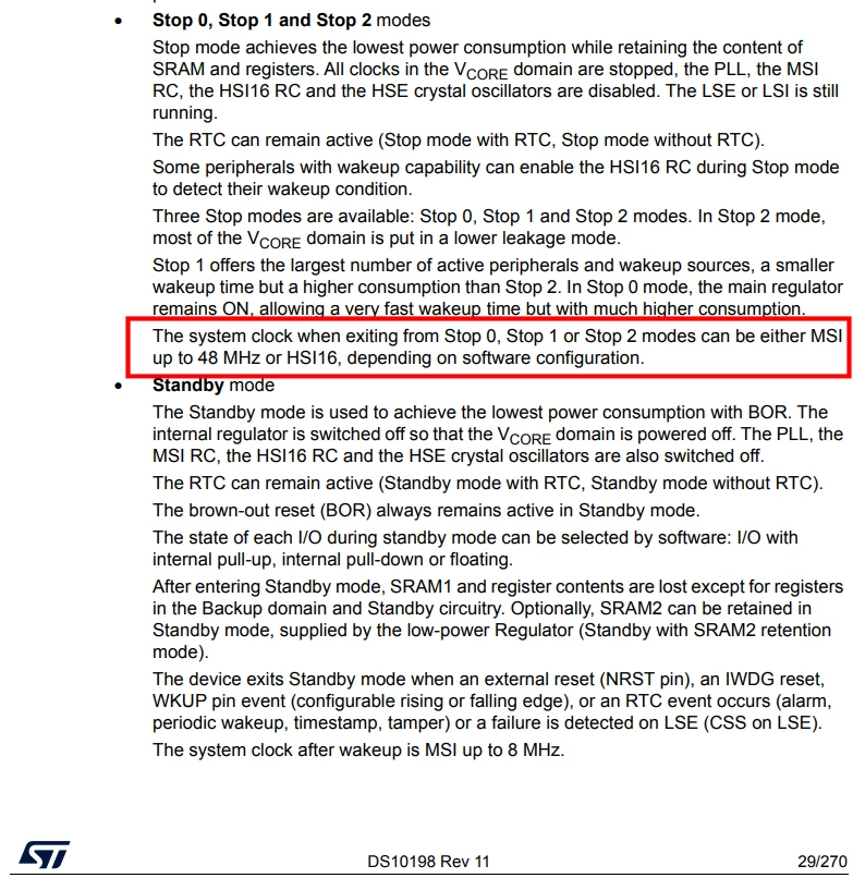

Andrew Neil
Jul 10, 2026 8:14 AM UTC
The datasheet tells you:
So, if that’s the configuration you want after exiting STOP - you don’t need to do anything.
If it’s not what you want then, of course, you will have to reconfigure it,
