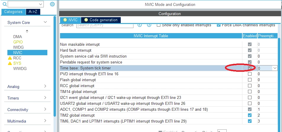

Is HAL_Delay() implemented with Interrupts?
Is HAL_Delay() implemented with SysTick() interrupt ?
Is ​it safe to use HAL_Delay() in while loop main.c
with other ( low priorities ) interrupts?
​Thanks
Karan​

Yes. By default it uses a counter which is incremented by the SysTick interrupt handler once every millisecond.

Do I need to change ​(lower) SysTick priority if I have HAL_Delay() in while (1). ?
​Where other high priority interrupts? ​
Karan​

The HAL_Delay() use the counter register of SysTick, but not the SyStick iterrupt.
The HAL_Delay() is an active polling loop waiting for SysTick interrupts.
This is why HAL_Delay() should not be used in an interrupt routine.

Thanks for update .. How to use HAL_Delay() in main.c while(1) with other interrupts but not inside the interrupts ?

By Below Priorities setup , the code stuck in infinite loop and then hardfault
Should I avoid HAL_Delay and use dummy delay as below ?

As @berendi​ replied, in main just call HAL_Delay. Unless you need delay while interrupts are disabled. Or unless you want more precise delay (microseconds). Just try it. Do not change the systick priority.

Execution time depends on lots of factors, e.g. interrupt activity, code alignment in flash. It can never be relied upon. Use a timer or a counter derived from a timer, like HAL_Delay().
