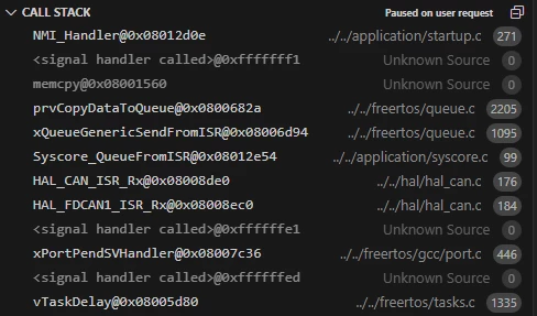

I am using an STM32G473 with FreeRTOS and am having issues with some interrupts sometimes causing an NMI, making the processor hang in the NMI_Handler (until the watchdog resets it if enabled).
The issue occurs sometimes, and I can always eventually trigger it when doing CAN Block Transfers, leading to many CAN Rx interrupts in quick succession.
From what I can see in the Call Stack, every single time I detect the issue, the interrupt seems to arrive/trigger when I am inside of a task switch. Example of the call stack:
So, here we have a task that has called vTaskDelay. The code pointed to in the delay function is portYIELD_WITHIN_API. My understanding is that this will cause a jump to
xPortPendSVHandler. My port of xPortPendSVHandler looks like this:

Which asm instruction we are at changes from run to run, but in this case we are at
stmdb r0!, {r4, r5, r6, r7, r8, r9, sl, fp, lr}
Here it looks like we get a CAN Rx interrupt. We end up in the handler for that interrupt, and traverse down to where it wants to put some data into a queue. The queue is very large and therefore will not be full. The memcpy is referred to in the call stack is the copy of the data into the write position of the queue.
The variables/pointers used in the memcpy looks to be OK.
After the memcpy we seem to end up in the NMI handler. I do not know why. I have tried to modify the NMI handler to see what the issue is but without luck. My NMI handler:

The CAN Rx interrupt is the only interrupt enabled, I have even disabled the tick interrupt. I have also disabled CAN Tx interrupts, since the Tx should be so far between that the FIFO/queue should never be full. I have a few different tasks still running in order to service the CAN messages.
Our FreeRTOSConfig.h is attached.
So, my question is split in two:
  1. Is it normal to allow and service an interrupt while doing a task switch? Can this mess up the state of the processor?
  2. What can cause the NMI in the CAN Rx interrupt? From my understanding the stacks look kind of OK, but I don't understand all of the contents.

So I did find a solution. The problem was that the RAM memory was not properly initialized, so the SRAM parity check caused an NMI exception. The weird thing was that no error bit was set though, so it took forever to find it.
The problem arose because we had some structs that was not fully packed, i.e. had some holes in them. In the CAN interrupt we malloc:ed some of these, assigned all the members, but the padding/holes were not initialized. Later we memcpy:d the full struct with padding, and that triggered the parity check/error.
Why this occurred only in the CAN interrupt is mainly because that's where we had the struct with holes, and probably because that at some points used heap that had not been used by any other task before.
To solve the issue, several things could be done. One solution could be to always memset the entirety of a malloc:ed struct. What we chose to do was to set all of the SRAM to 0 at startup. That let us never have to think about the initialization at multiple sites.

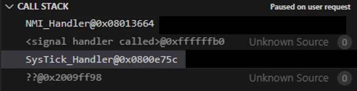

Hello Andreas,
Do you find any solution for this problem ?
I currently have exactly the same issue on a STM32H573 using FreeRTOS.
My code ends up stuck in an NMI_Handler, each time from different functions but always linked to FreeRTOS or an interrupt :
For debugging purposes, I display in my console the contents of some SCM (System Control Block) registers in order to understand the origin of the NMI_Handler.
void NMI_Handler(void)
 /* USER CODE BEGIN NonMaskableInt_IRQn 0 */
 printf("NMI Occurred!\n");
 printf("ICSR: 0x%08lX\n", SCB->ICSR);
 printf("CFSR: 0x%08lX\n", SCB->CFSR);
 printf("HFSR: 0x%08lX\n", SCB->HFSR);
 printf("BFAR: 0x%08lX\n", SCB->BFAR);
 printf("SHCSR: 0x%08lX\n", SCB->SHCSR);
 /* USER CODE END NonMaskableInt_IRQn 0 */
 /* USER CODE BEGIN NonMaskableInt_IRQn 1 */
 while (1)
 /* USER CODE END NonMaskableInt_IRQn 1 */
In my case, I get the following result:
The SHCSR=0x00000020 register means that the PendSV exception is active.
