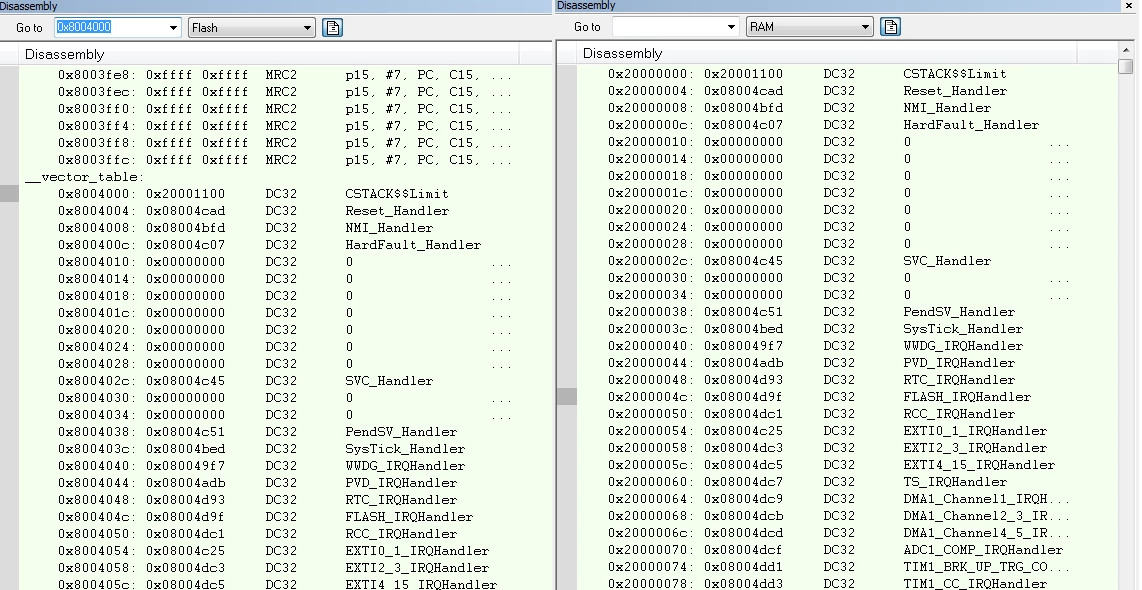

I thought it worked... now that I solved getting and writing the binary when I jump to 0x8004000 the app works except interrupts the first thing I do is remap table, I verified that the interrupts vector is in its place in RAM. the  EXTI0_1_IRQHandler or SysTick_Handler never gets called even if I init them the same way I do in the main residing at 0x8000000.
        VectorTable[i] = *(__IO uint32_t*)(APPLICATION_ADDRESS + (i<<2));

I did one more test, from the AN4065 I loaded the project App2 on to 8003000 and Ap1
onto 8000000, I modified App1 to jump to App2 on push button, I modified App2 to flash my discovery-board Leds not the eval-board ones, if I jump to App2 from the modified App1 then App2 systick timer works and delays keeps flashing leds. If I Jump from my App1 (my IAP ) using the same jump to function , the leds on App2 work but not the systick so I get stuck on Delay. So the App2 is not independent from the App1 because if I jump from my App1 interrupts don't work but the same App2 has working interrupt if I jump from another App1 ? Again I did another test, if I call the jump to App2 from Button interrupt routine then at App2 interrupts don't work, but if I call it from main polling button or Polling a variable modified by the button interrupt they work even from my Evil App1 code. why I can't jump from inside a Interrupt ?

RCC_APB2PeriphResetCmd(RCC_APB2Periph_SYSCFG, ENABLE);         !!NOT RESET!!
You want to enable the Clock
  //SYSCFG_MemoryRemapConfig(SYSCFG_MemoryRemap_SRAM);
    SYSCFG_MemoryRemapConfig(SYSCFG_MemoryRemap_SystemMemory);  !!NOT ROM!!

Posted on May 25, 2016 at 17:28
