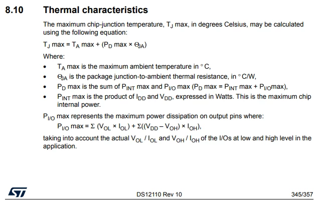

This sounds like entirely expected behaviour.
The operation of the chip generates heat internally.
The so-called thermal resistance of the package means that the internal temperature will be higher than the external temperature.
When you artificially raise the external temperature, the process is reversed - heat flows into the package, and the thermal resistance means that the internal temperature is lower than the external.
Take a look a this article - Basics of Thermal Resistance and Heat Dissipation:
https://fscdn.rohm.com/en/products/databook/applinote/common/basics_of_thermal_resistance_and_heat_dissipation_an-e.pdf
Addendum:
https://www.st.com/resource/en/datasheet/stm32h743zi.pdf#page=345
See also AN5036, Guidelines for thermal management on STM32 applications:
https://www.st.com/resource/en/application_note/an5036-guidelines-for-thermal-management-on-stm32-applications-stmicroelectronics.pdf

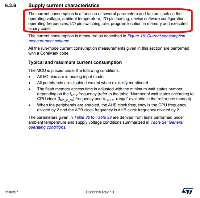

Andrew Neil
Sep 17, 2024 12:50 PM UTC
@SITARAM wrote:
it is possible to increase temperature from the stable temperature ,it is possible to increase  or it give stable temperature 46 0r 47 degree ?
Power Dissipation is closely related to current consumption:
So take a look at those Tables 30 - 38 (on the following pages of the datasheet) to see what's going to make the most significant difference to current consumption ...
https://www.st.com/resource/en/datasheet/stm32h743zi.pdf#page=110
