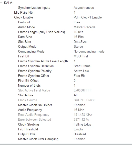

I have a STM32H747I-DISCO I want to use to record audio. In my test code I tried to record 3 seconds of audio after pressing the JOY_SEL button. I tried to setup the configuration of peripheral SAI4 for PDM and to use DMA and PDM2PCM using the CubeMX tool. I also tried to just use the BSP provided by ST for the discovery board. I was not able to get either the manual configuration or the BSP configuration to work. I have already looked at AN5027 and the examples provided by ST in the STM32Cube_FW_H7_V1.12.1 repository. The examples provide audio recording but for different boards. The DFSDM example for this board is not that useful when using SAI for communication. Any guidance or detailed procedure on how to setup the on-board digital microphone using SAI for the STM32H747I-DISCO is much appreciated!
Manual/BSP Setup:
CPU ICache enabled
CPU DCache enabled
FreeRTOS enabled
GPIOs for joy stick button configured
TIM6 and TIM3 used for sysclks for Core M7 and Core M4 respectively. (because of FreeRTOS)

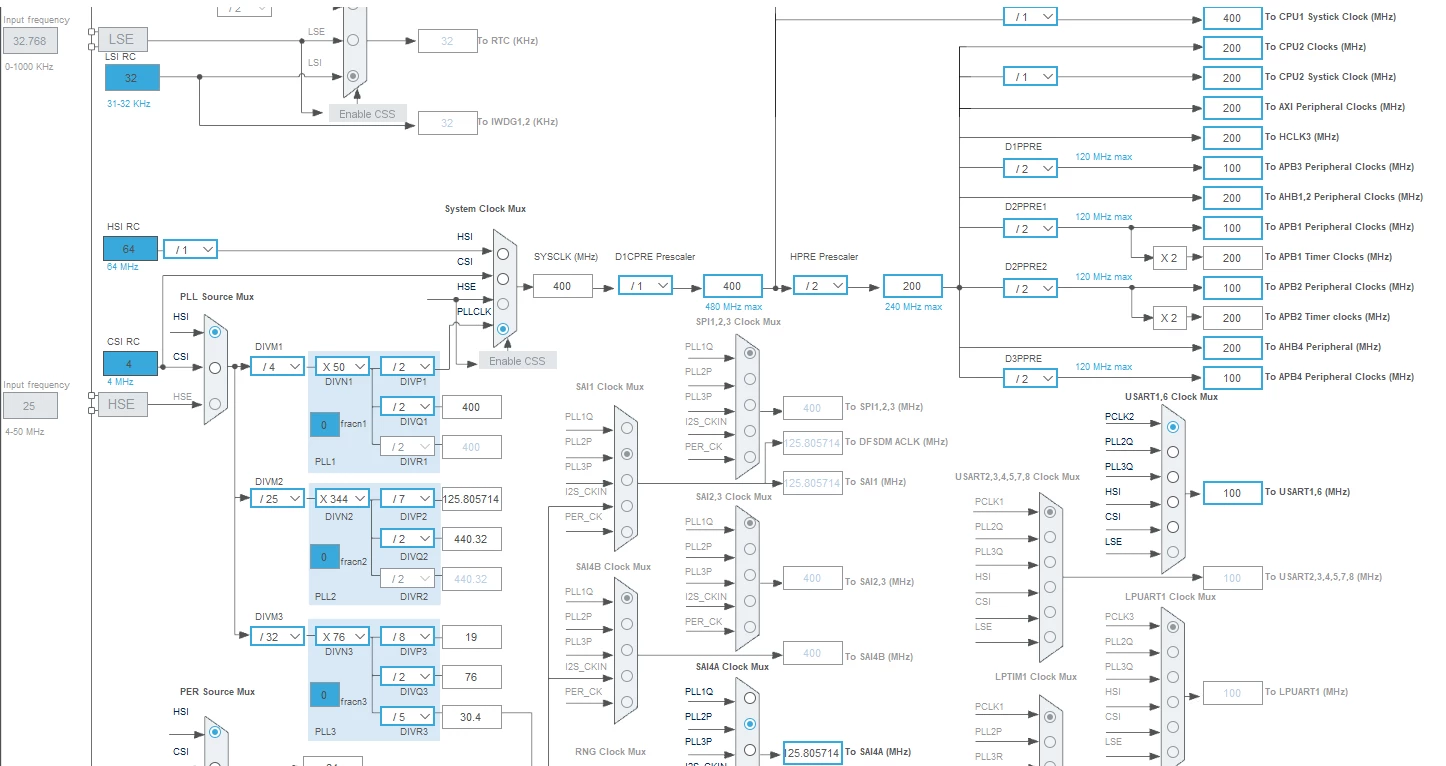

SAI4 - PDM using MicroPhones pairs (1-2) and CK1 as clock, DMA is also setup, Mode: Circular, Data Widths: Half Word, Increment Memory
Clock Configuration:
For the manual setup, I did not include the stm32h747i_discovery_audio.c and other BSP files in the project.

This setup I was not able to make it past HAL_SAI_Receive_DMA(&hsai_BlockA4, dma_buf, PDM_BYTES_PER_MS / 2) and the LED recording light never turns off.
