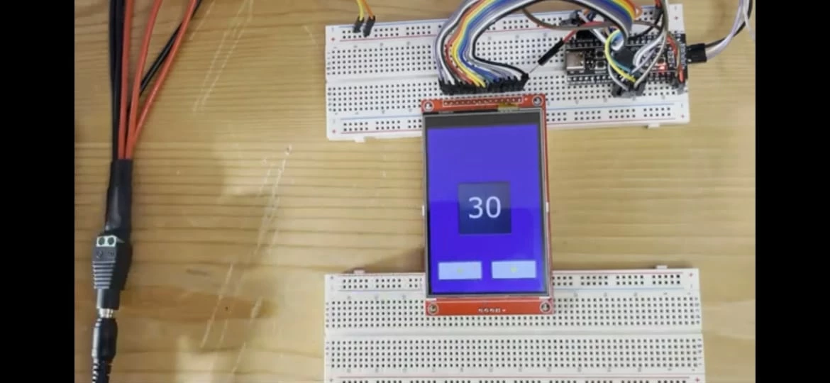

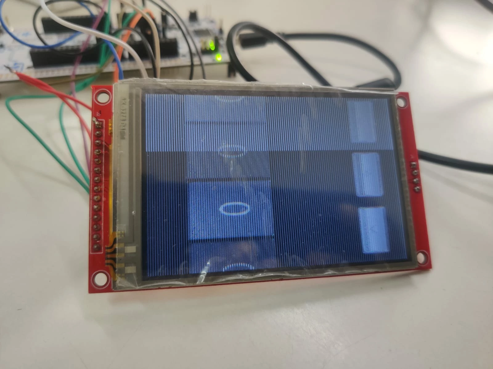

hi i am able to display the image ,now i am working on the touch part and i was referring to a youtube video https://youtu.be/g1siKaPox88?si=GkSLNO9t5GLuSTK5  from this video they had given a code and i was able to display but it is showing in gray scale but the touch is working ,in the video they have made a number increment and decrement using buttons in touchgfx designer
