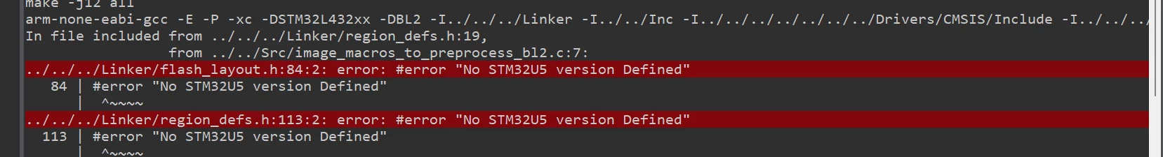

I need to run the example on STM32L432xx development board. Apparently, this board is not supported by this example. So, I manually added the drivers related to the STM32L432xx board in the respective locations. The updated command in the STM32CubeIDE is as under, I have also attached the updated project with the post.
arm-none-eabi-gcc -E -P -xc -DSTM32L432xx -DBL2 -I../../../Linker -I../../Inc -I../../../../../../../Drivers/CMSIS/Include -I../../../../../../../Drivers/CMSIS/Device/ST/STM32L432xx/Include -I../../../../../../../Drivers/STM32L4xx_HAL_Driver/Inc -o./output.ld ../STM32L432KCUX_FLASH.ld && arm-none-eabi-gcc -E -P -xc -DSTM32L432xx -DBL2 -I../../../Linker -I../../Inc -I../../Inc -I../../../../../../../Drivers/CMSIS/Include -I../../../../../../../Drivers/CMSIS/Device/ST/STM32L4xx/Include -I../../../../../../../Drivers/STM32L4xx_HAL_Driver/Inc -o../image_macros_preprocessed_bl2.c ../../Src/image_macros_to_preprocess_bl2.c
The file `image_macros_to_preprocess_bl2.c` is defining some address locations and I could not resolve that. It seems to be related to the specific memory layout of the board. I am getting the following error when trying to build my project.
Kindly help me in getting out of it. Or recommend me some easy way to integrate MCUboot to my STM32L432xx project.
Thanks in advance.

Jocelyn RICARD
May 14, 2025 7:20 AM UTC
Hello @racemax ,
You already have mcuboot examples available for other families integrated in STM32CubeIDE.
So, this is only a matter of porting on this target.
Also, you have already a secureboot solution running on STM32WB55 which is provided in X-CUBE-SBSFU package. It is not based on mcuboot tough.
Best regards
