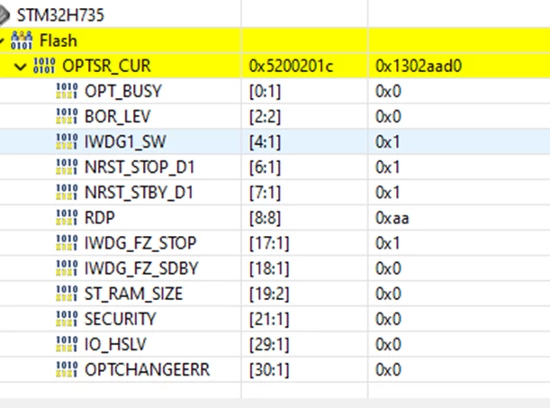

I am using software Independent watchdog at STM32H735IGK and i want to freeze it when entering standby mode.
I set option byte FW_IWDG_SDBY unchecked but unfortunately it is not working and my program keeps getting out from standby mode.
My code:

Option bytes seen at Cube Programmer:
Thanks by advance!

At CubeProgrammer it says: "Unchecked: independet watchdog is freezed in STANDBY mode. Checked: Independent watchdog is running in STANDBY mode".
I want the independent watchdog to be freezed at standby mode.
I have checked corresponding reg and it is set to 0 which acoording to RefManual:
"Bit 18 IWDG_FZ_SDBY: IWDG Standby mode freeze option status bit
When set the independent watchdog IWDG1 is frozen in system Standby mode.
0: Independent watchdog frozen in Standby mode
1: Independent watchdog keep running in Standby mode."

After executing
HAL_PWR_EnterSTANDBYMode();
When the watchdog time ends (in my case ~8sec), the program resets and i observe at RCC->RSR that the flag RCC_FLAG_WWDG1RST is set.
