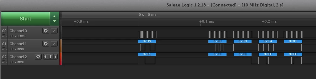

I am running a simple SPI transmit receive project with an STM32F411 (SPI Master) and STM32F303 (SPI Slave). Whenever I press the user push button on the STM32F4 Master, the Master will send a command byte (0xE1) through SPI and the STM32F3 Slave is expected to respond with 4 particular bytes. The snapshot of the logic analyzer below is what I expect to happen every single push button:

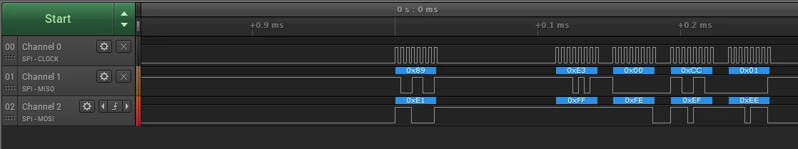

I could probably get the accurate SPI transaction above several times. However, most of the time, the snapshot below is what occurs:
After running through many tests, I am almost certain that the Slave is the issue because:
  • The Master almost all the time transmits the correct data observed through the Logic Analyzer
  • The STM32F3 Slave actually receives the correct data (the command byte and the 4 dummy bytes)

It looks like the CPHA setting on your logic analyzer doesn't match the CPHA setting on your device. The waveforms are the same.

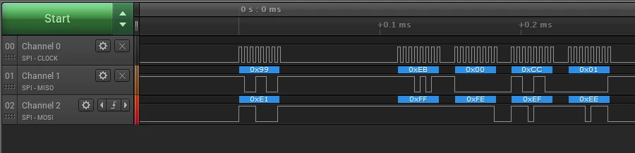

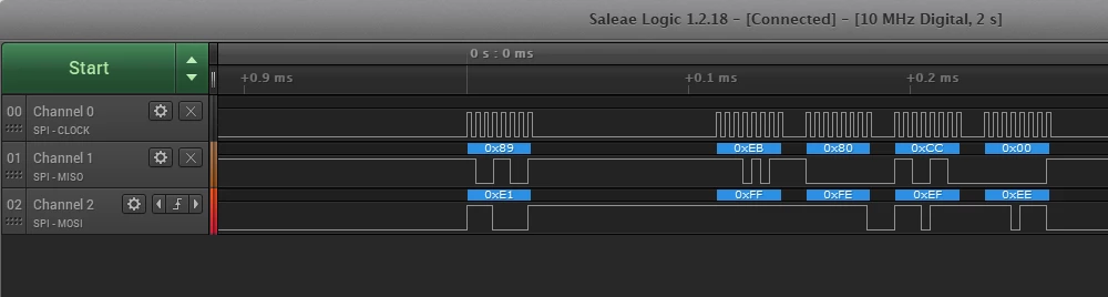

I don't know how I missed this. I was too focused on the code that I forgot to consider how the logic analyzer configuration might be incorrect itself. Thank you for the solution!
Both of the code's configuration was CPOL = 0 and CPHA = 1 (2nd edge), but the logic analyzer was configured to CPOL = 0 and CPHA = 0. I am reading the correct waveforms now.
I do have a question regarding the logic analyzer's readings though. Why is it that when the logic analyzer is configured to CPOL = 0 and CPHA = 0, the readings are always different? I would imagine that if the configuration is wrong, the waveforms produced would be wrong but it would show the same incorrect data all the time.
Jul 21, 2020 6:45 PM UTC
