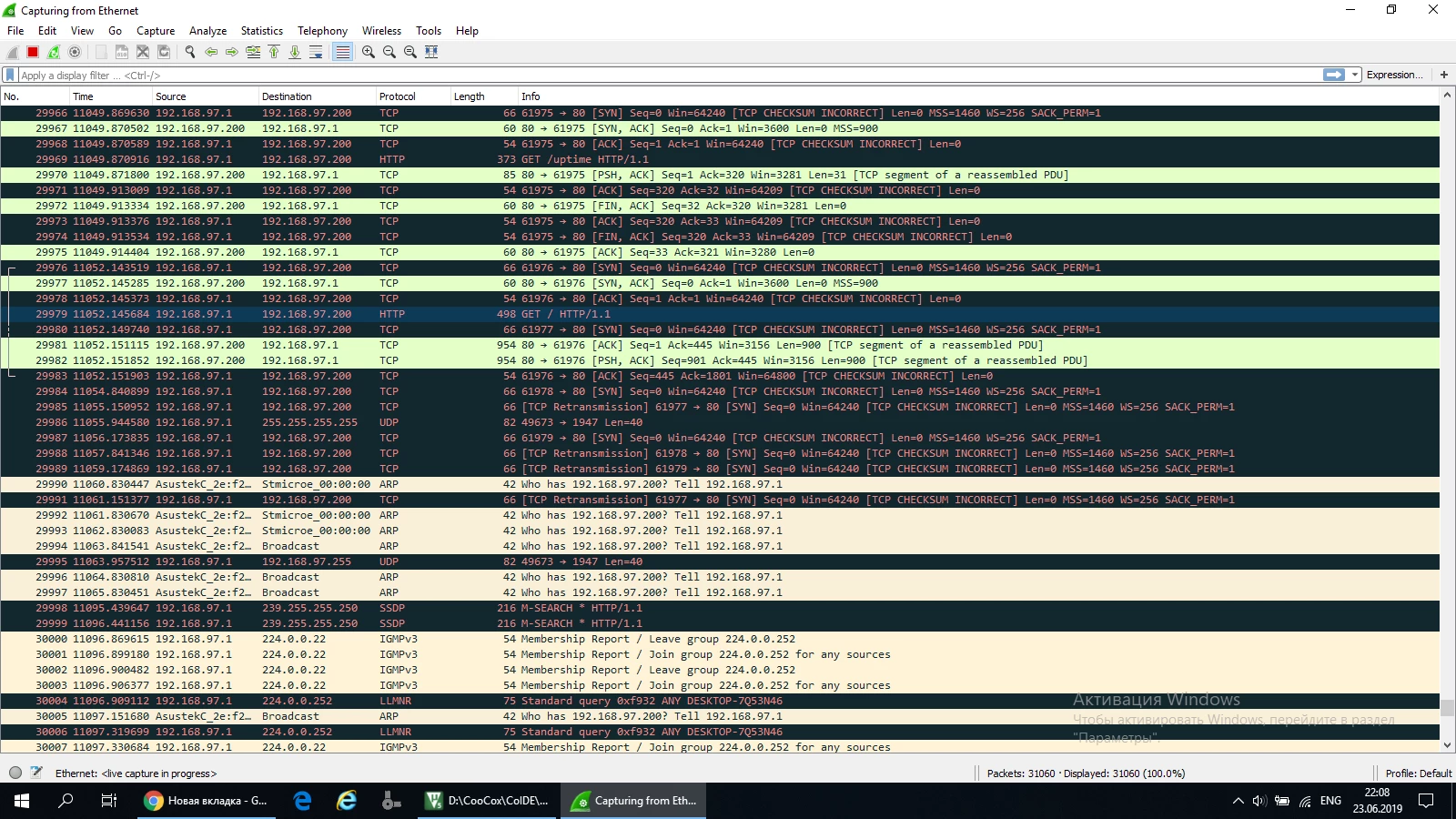

Incomprehensible behavior with the LWIP library.
Recently I switched to STM32F767ZI using LAN8742A and the LWIP library. Began to develop a web configurator based on this STM. And there is such a problem. 0690X000008j6C9QAI.png
where 192.168.97.200 is a device, 192.168.97.1 is a client (computer).
During data transfer to get, the request goes to a packet with the SYN flag, after which the device does not transmit data, does not respond to ping.
The code is presented below.

Who knows what the problem is? Thank you in advance. (I want to add that I'm doing a multiplayer web configurator.)
1 reply
valik mahrov
June 26, 2019
Here is a file to make my problem easier to understand. The problem begins with the package number 62733.
