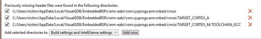

include CMSIS folders
Posted on June 03, 2018 at 05:16
with soooooooo many options for evvvvererereryyyy thing
I am work on bringing up my new project, using the STM32H753
please tell me this is ok ?
how does Cortex-A relate ?
The H series Reference manual: ARM� Cortex�-M7
there is no reference to Cortex-A in the manual.
on the ST page, also no mention of Cortex-A
http://www.st.com/en/microcontrollers/stm32h7-series.html?querycriteria=productId=SS1951
on ARM Cortex-A,
no mention of the STM32H series :
https://www.arm.com/products/processors/cortex-a

It’s all fixed.
I restarted my new embedded project in Visual Studio.
I used UltraFileSearch to find the files within the project structure.
Then added that path to the project makefile settings.

This is strange! But,in order to figure out the cause of this message we need more inputs. Could you share more details: Are you building your own project? Please check your IDE settings and share them with us.

It’s all fixed.

Happy to know that the issue is fixed!
I'm not able to see the attached images.
