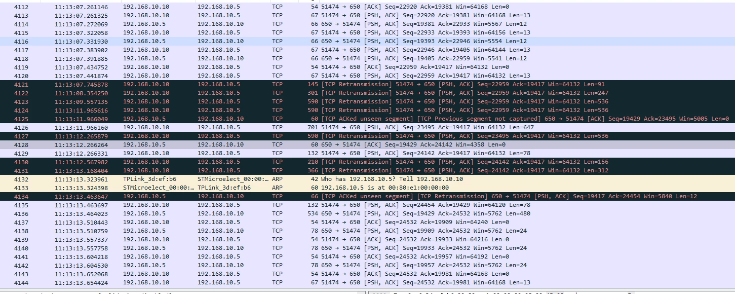

In STM32H743IITx with every 10min of interval DMA Error in DMACSR register RBU=1 ETI=1 AIS=1
 I am using the core STM32H743IITx with Dev board OpenH7XXI-C.
 PHY IC - DP83848,With RMII configuration.
 I am facing issue in Ethernet communication for every 10 min of interval, I am getting DMA Error with RBU,ETI,AIS   bit in DMACSR is set.
 but after few sec(30 to 40sec), It is reconnecting again.
DMA descriptors allocated in RAM_D2 section.
LWIP_RAM_HEAP_POINTER @ 0x30020000
guidance on why this issue happens with regular interval will be helpful

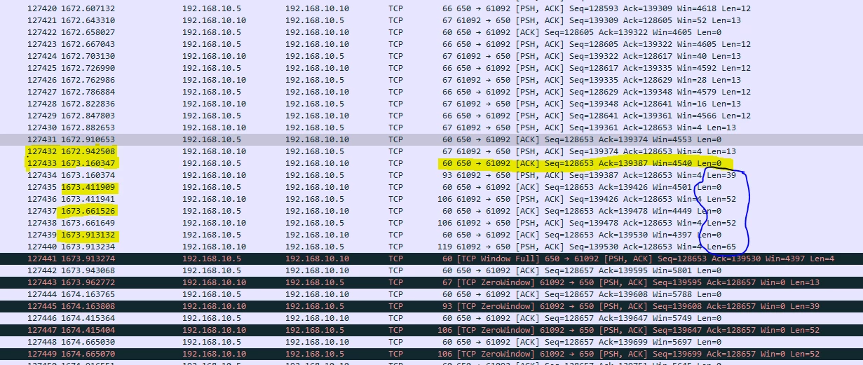

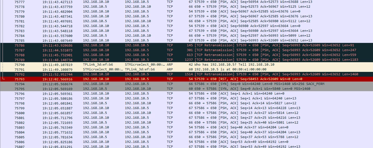

every 10 min it is reconnecting the ETH connection before reconnection
1. Buf was overlaping
2. TX RX suspended (DMA Error with RBU,ETI,AIS   bit in DMACSR is set.)
3. For 30 to 45 seconds it is in this state only after 45 seconds with my reconnection logic in freertos thread it is getting reconnect.
Default task is having Highest priority than start_Task3.

@STackPointer64  @LCE  Now,
I am not getting RBU DMA error but still,
Case 1: my STM32 not ack segments from peer and peer is requesting retransmission req continuously.
and lead to RST connection
within few min reconnecting continuously.
Case2 : Out of packets from peer. lead to retransmit req  from peer (During retransmission req from peer my Eth IRQ is not triggering), This lead to pause in communication :(
