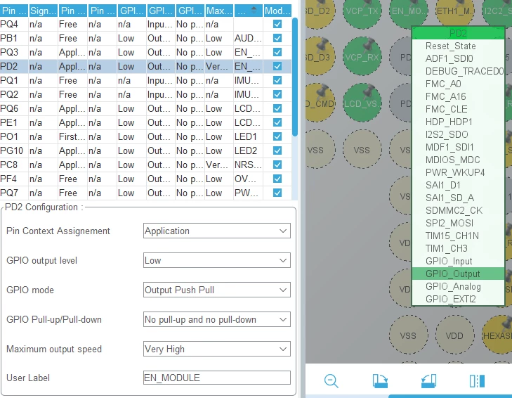

Best answer by VitorWagner
Hello once again,
By discussing with ST, the issue has been solved. For anyone that wants to recreate the DCMIPP Continuous Mode, here are some things to keep in mind:
The NRST and ENABLE pins that connect the STM32N6570-DK to the MB1854B board are not configured by default, so you need to configure the pins as GPIO Outputs and to the context of your project. Keep in mind that NRST is active low as well.
When using the DCMIPP with CSI, you won't actually see it in the clock tree, but the CSI requires a correct clock configuration as well, which is connected to IC18, you should configure it's frequency to, at maximum 20MHz, if I'm not mistaken.
You can assure your IC18 configuration is correct by looking at the hal_msp.c file after CubeMX code generation.

Hello once again,

If you have correctly configured the CSI clock and enabled the camera module, your IMX335_ReadID function should return the correct ID of the camera, or you can just use your own functions with I2C to read the ID as well.
Most of the other specifications are not hard to figure out, but in order to keep it short, I only included my main issue here, if anyone reading encounters other issues by trying to recreate the project, I most likely have found them and solved them in my project, so i'd be happy to lend a hand.

By displaying images on the display you probably mean using HAL_LTDC_SetAddress() to an array of a custom image or something of the sort right? If so that's a great first step.
While I cannot go into great details of my application, following this checklist should help:
- Configure the CSI-2 frequency to 20MHz
- If you are using CubeMX, check if your NRST and ENABLE pins of the camera are in the right context (FSBL or Application)
- Ensure your Pixel Pipe Patch matches the resolution you are trying to display, by default if you are going for 800 width, it should be configured to 1600.
- Ensure your downsize configuration also matches the resolution, if you search for the downsize section in the STM32N657xx manual you can find the formula, but if you follow the values in the example, you will end up with a downsize of 2592x1944 (original camera resolution) to 800x480.
- Be absolutely sure your flat cable is correctly connected to the camera module, I myself had some issues with it's delicate pins, so use a multimeter or something of the sort to make sure your pins from the board are connected to the camera module.
- Use the BSP drivers located in the example, even though you could recreate the example without them, it makes the journey alot easier, and you can also just copy and paste the example if your enviroment is correctly configured for a quick test as well.
- Enable your SRAMs if you are using the same memory address as the example, 0x34200000 if I am not mistaken, by default their enable register comes disabled, and you won't be able to read or write in that address if the memory is not enabled.
- Make sure your peripherals are configured in the RIF section, so they have privelege when accessing memory sections, especially the CSI and DCMIPP, if you are using the LTDC with the address directly configured to that memory section, you might have to enable it for the LTDC as well, I am not 100% sure.
Those are the points I can remember from the top of my head, feel free to send me DMs, some people have already contacted me regarding that example so I might make a forum post sharing a repo if I am allowed to do so, eitherway, if your problems are connected to simply recreating the example, I can lend a hand once I have some free time.
