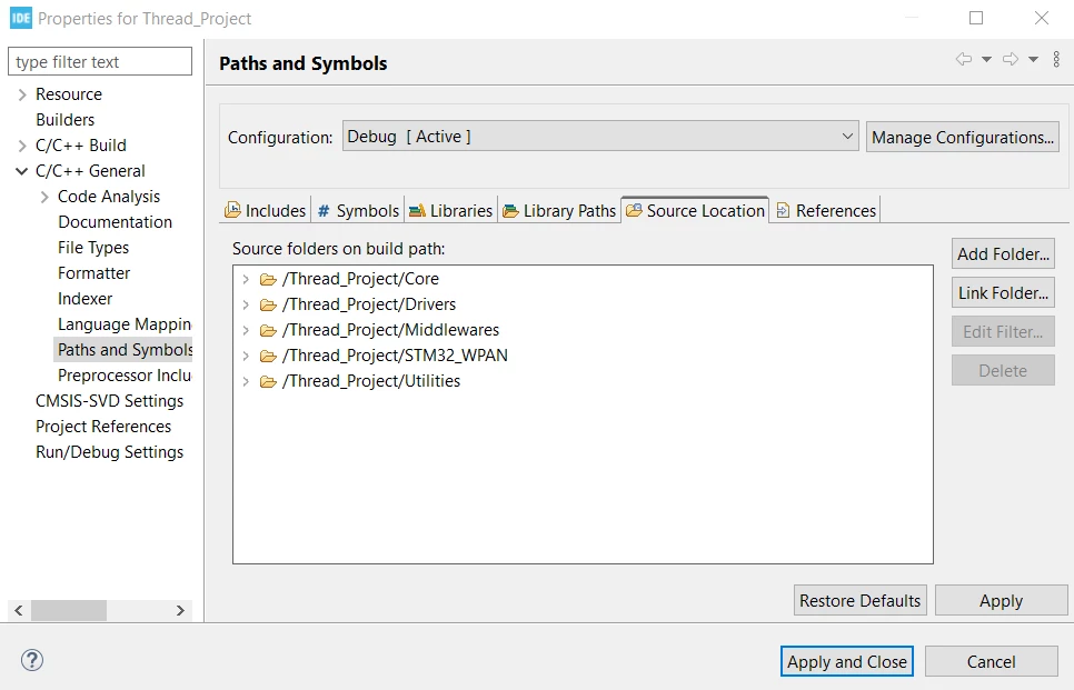

  9. Generate the project and verify the project setting to be sure that all source path are included as follow :Ouadi_3-1707936599295.png
You have now a clean project that includes Thread APIs ready to be used for your own application.
