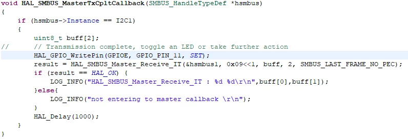

PSR1Author
Sep 13, 2024 10:37 AM UTC
"I'm transmitting the address using this function:
HAL_SMBUS_Master_Transmit_IT(&hsmbus1, 0x09 << 2, buff, 2, SMBUS_FIRST_AND_LAST_FRAME_NO_PEC);
I placed the code to turn on the LED inside the function:
HAL_SMBUS_MasterTxCpltCallback(SMBUS_HandleTypeDef *hsmbus);
However, I am unable to receive a response when using the following receive function:
HAL_SMBUS_Master_Receive_IT(&hsmbus1, 0x09 << 1, buff, 2, SMBUS_FIRST_AND_LAST_FRAME_NO_PEC);"
could you please help to get the response from Battery IC(BQ25720).
Thanks & Regards,
PSR
Sep 13, 2024 1:45 PM UTC
Hello @PSR1
Is the HAL_SMBUS_MasterTxCpltCallback() get called?
If yes, you need to change the XferOptions setting.
HAL_SMBUS_Master_Transmit_IT(&hsmbus1, SlaveAdress, buff, 2, SMBUS_FIRST_FRAME);
// Wait for the end of transmit operation
HAL_SMBUS_Master_Receive_IT(&hsmbus1, SlaveAdress, buff, 2, SMBUS_LAST_FRAME_NO_PEC);
Why you are using two different addresses for transmit and receive. It is the same slave; the address should be the same.
It is mentioned in the slave datasheet that the SMBUS address is 0x12h (0x09h<<1).
In order to give better visibility on the answered topics, please click on 'Best answer' on the reply which solved your issue or answered your question. Saket_Om
PSR1Author
Sep 16, 2024 6:12 AM UTC
Hi, Saket_om.
1. I use the same address for master transmit and receive. The receive function is
Ret = HAL_SMBUS_Master_Receive_IT(&hsmbus1, 0x09<<1, buff, 2, SMBUS_FIRST_AND_LAST_FRAME_NO_PEC);
If (ret == HAL_OK) {
LOG_INFO("HAL_SMBUS_Master_Receive_IT:%d%d\r\n",buff[0],buff[1]);
I'm unable to retrieve the buffer values.
2.How to access various registers of the battery IC (BQ25720) using the SMBus protocol.
Could you help me?
Thanks & regards.
PSR
Sep 16, 2024 8:46 AM UTC
Hello @PSR1
You should use the option SMBUS_LAST_FRAME_NO_PEC and not SMBUS_FIRST_AND_LAST_FRAME_NO_PEC.
PSR1Author
Sep 16, 2024 9:30 AM UTC
HI Saket,
I implemented my code based on your suggestion, but scenario is not changed.
1. In this function Led is Turned on, after that no response from Master_receive _IT function.
2. also could you please suggest 2nd point from previous query.
Thanks
PSR

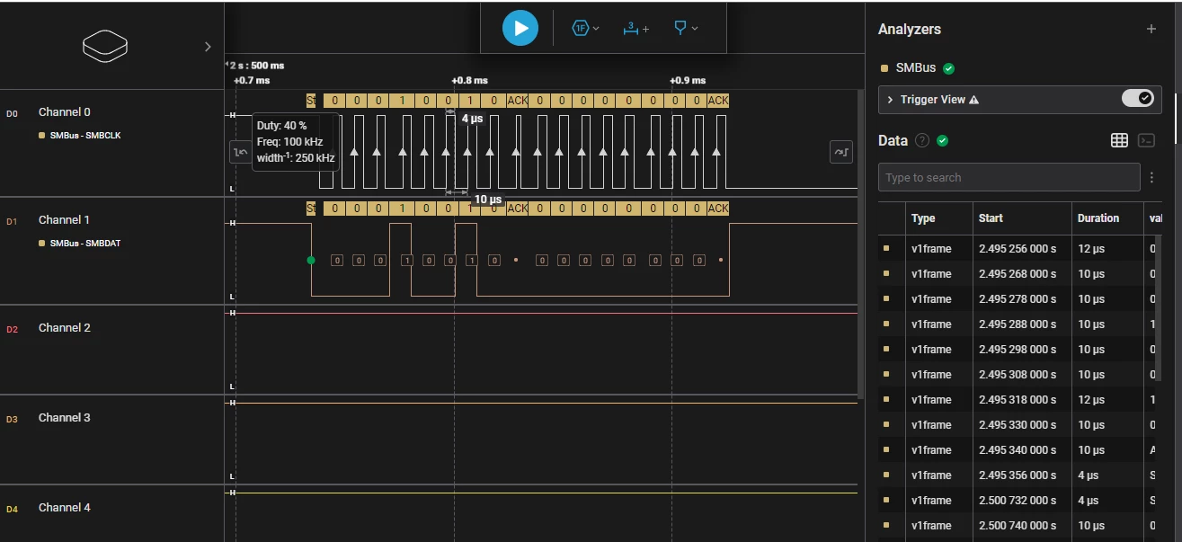

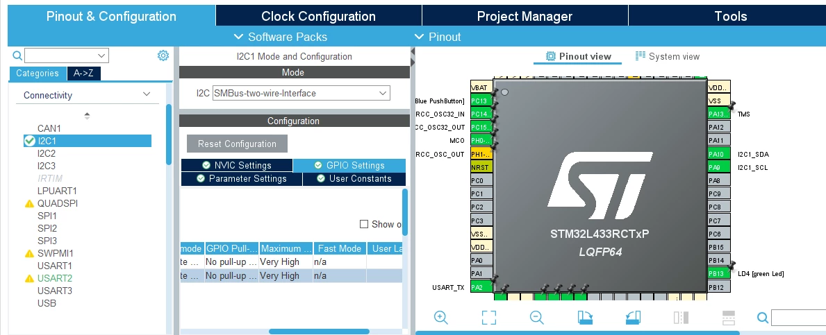

PSR1Author
Sep 20, 2024 8:59 AM UTC
Hello @Karl Yamashita,
        Please see the attached bq25720_evm.pdf. I connected L4 series SDA and SCL lines, and everything I did for your information was implemented; please review the logic analyzer output of SMBus lines.
Thanks,
PSR.
