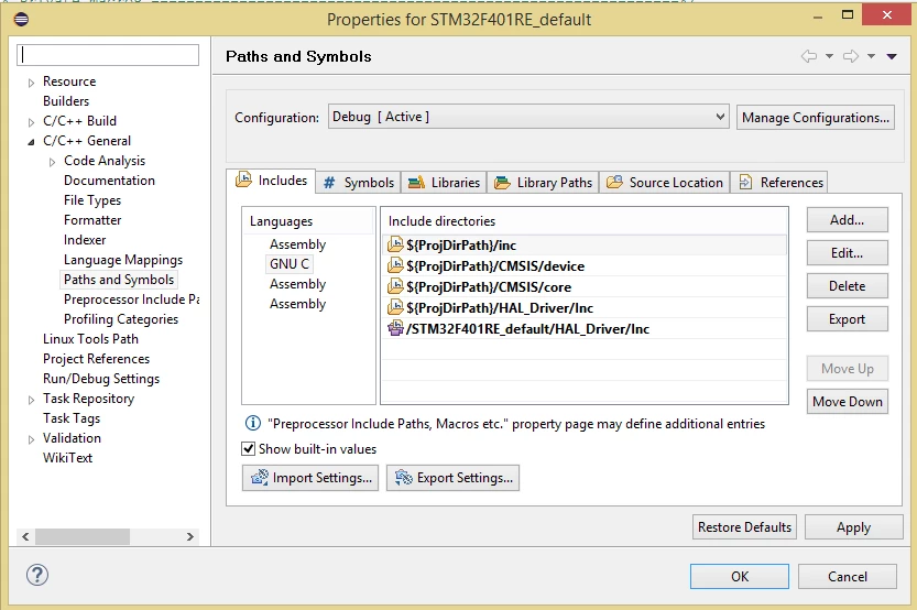

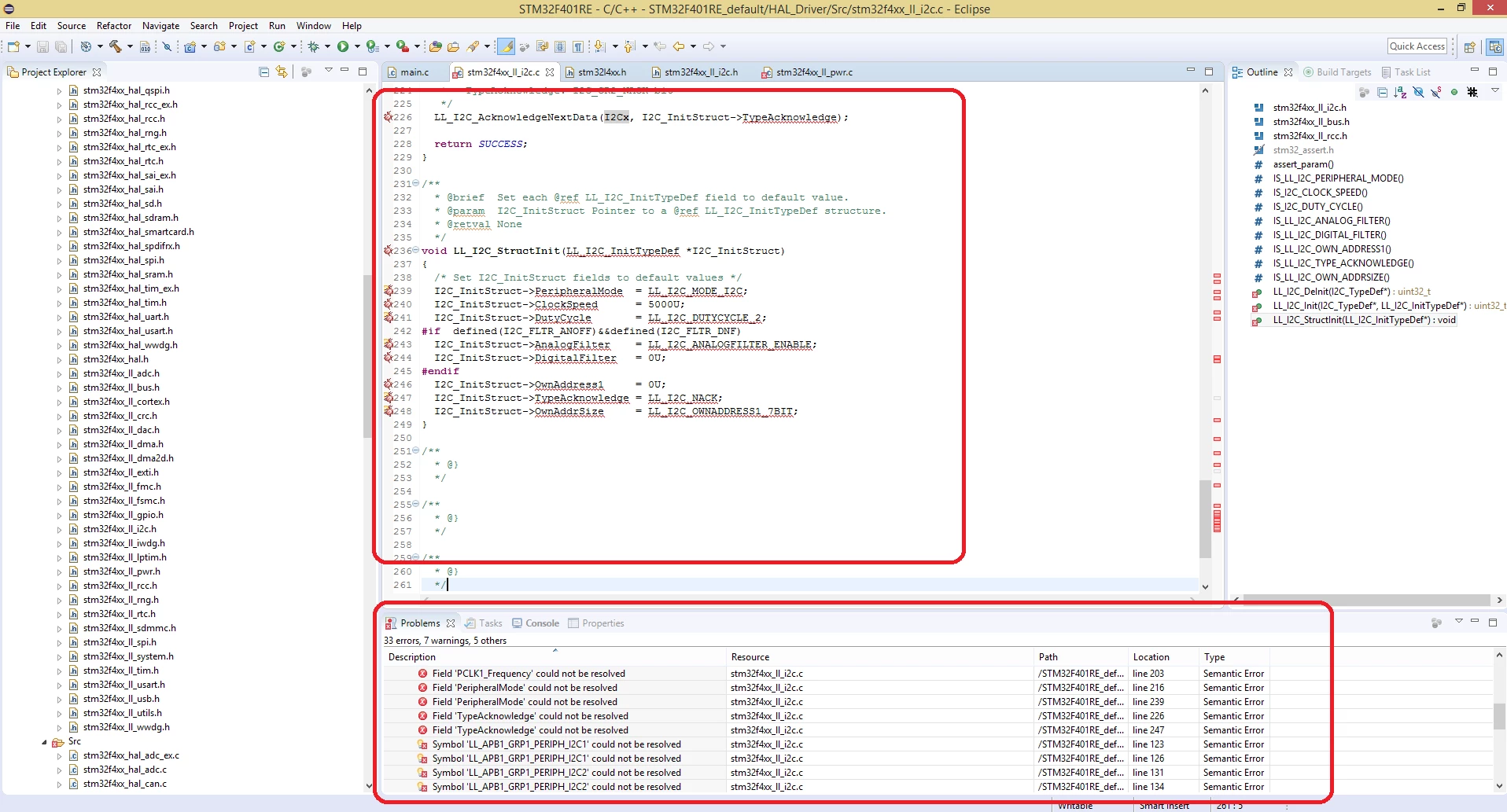

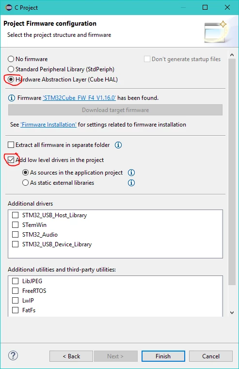

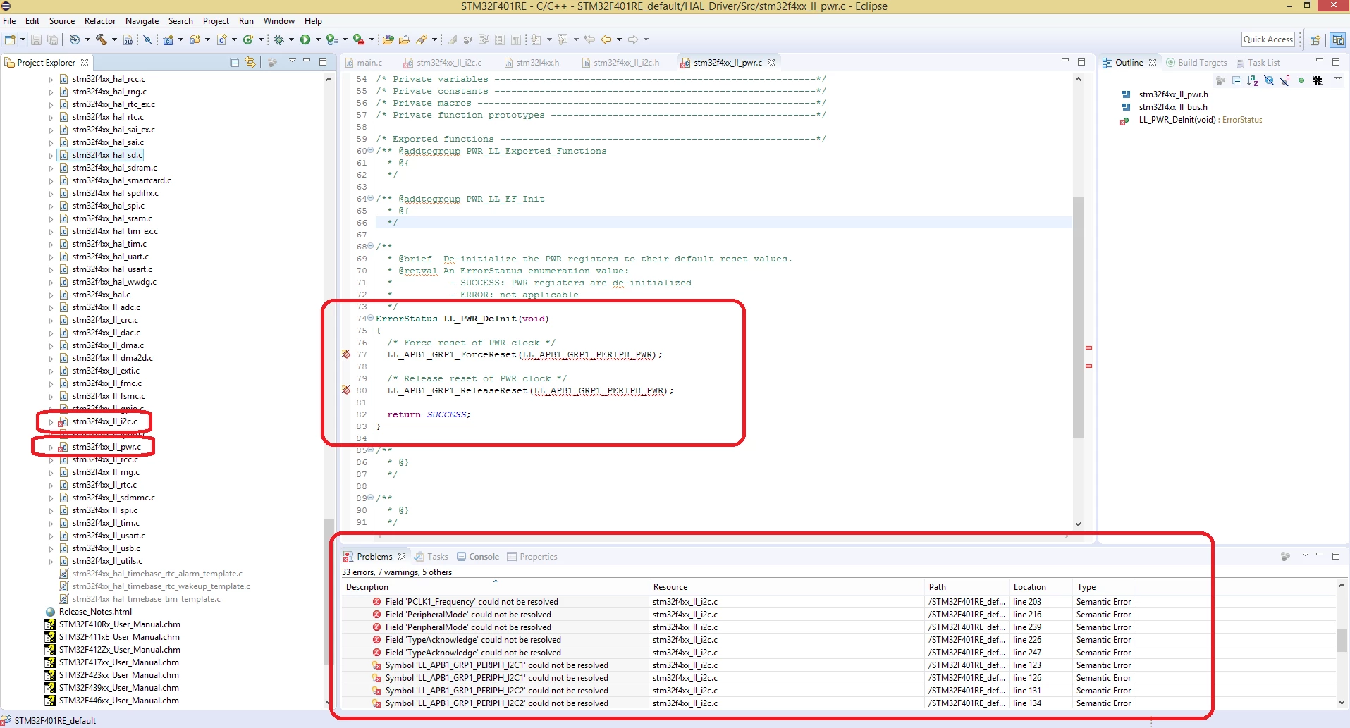

Hello I am trying to create new empty project only with HAL and CMSIS in SW4STM32. I've got STM32F401 and I want to use LL drivers. I create new C project and I set HAL drivers, HAL drivers have also LL driver. How can I use LL drivers? I get some mistakes. Below I put some pictures of this problem.

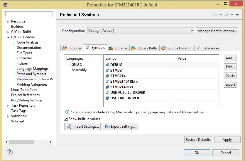

Your answer is confusing. I know that LL and HAL are included. But LL drivers are disabled, when you use symbol USE_FULL_LL_DRIVER you get some errors...
This is true solution!
http://www.openstm32.org/forumthread5888?topics_offset=0

Review the LL Template for your tool chain
STM32Cube_FW_F4_V1.16.0\Projects\STM32F401RE-Nucleo\Templates_LL\SW4STM32
You'd want to have the defines passed in by the compiler
USE_FULL_LL_DRIVER
STM32F401xE
HSE_VALUE=8000000U
And the Include Paths to encompass those of the drivers and project

Yes, but the LL drivers are extern of project. I want all files in one folder(project).

Ok, so copy them in one directory and construct the project. Pretty trivial task for GNU/GCC makefile, or Keil, can't believe it could be unduly complex in anything else.

Hello !
I have SW4STM32 v. 4.6.3
When create a project, for your MCU , at this screen you can choose between SPL and HAL
In case you choose HAL you have the option to add LL drivers in project.
I tried to make an empty C project for f401RE with HAL and LL and didn't faced the behaviour you described.
Check if you have the latest versions of firmware and SW4STM32.
Regards
vf
