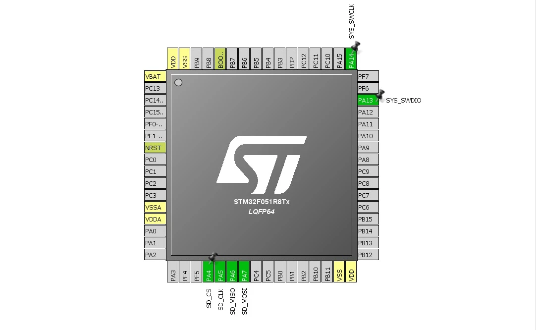

Greetings,
I am trying to implement SPI based fat file system in stm32F0 Discovery Board. I want to use HAL SPI.
My connections are as show in image.
Any guidance or sample code for implementing fat file system will be of great help.

In the HAL trees are a couple of relevant examples
STM32Cube_FW_F0_V1.9.0\Drivers\BSP\Adafruit_Shield\stm32_adafruit_sd.c
STM32Cube_FW_F0_V1.9.0\Middlewares\Third_Party\FatFs\src\drivers\sd_diskio.c
STM32Cube_FW_F0_V1.9.0\Projects\STM32F091RC-Nucleo\Applications\FatFs\FatFs_uSD
port as appropriate
SPI read/write code supporting the Adafruit library is in the BSP
Nimit Vachhani
October 3, 2018
Thanks Clive for reply. I have gone through those examples. Finally i have decided to move on to STM32F103 controller with SDIO bus.
