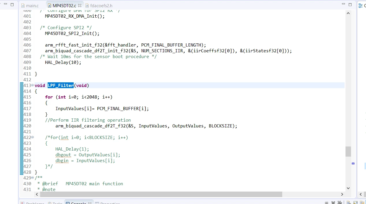

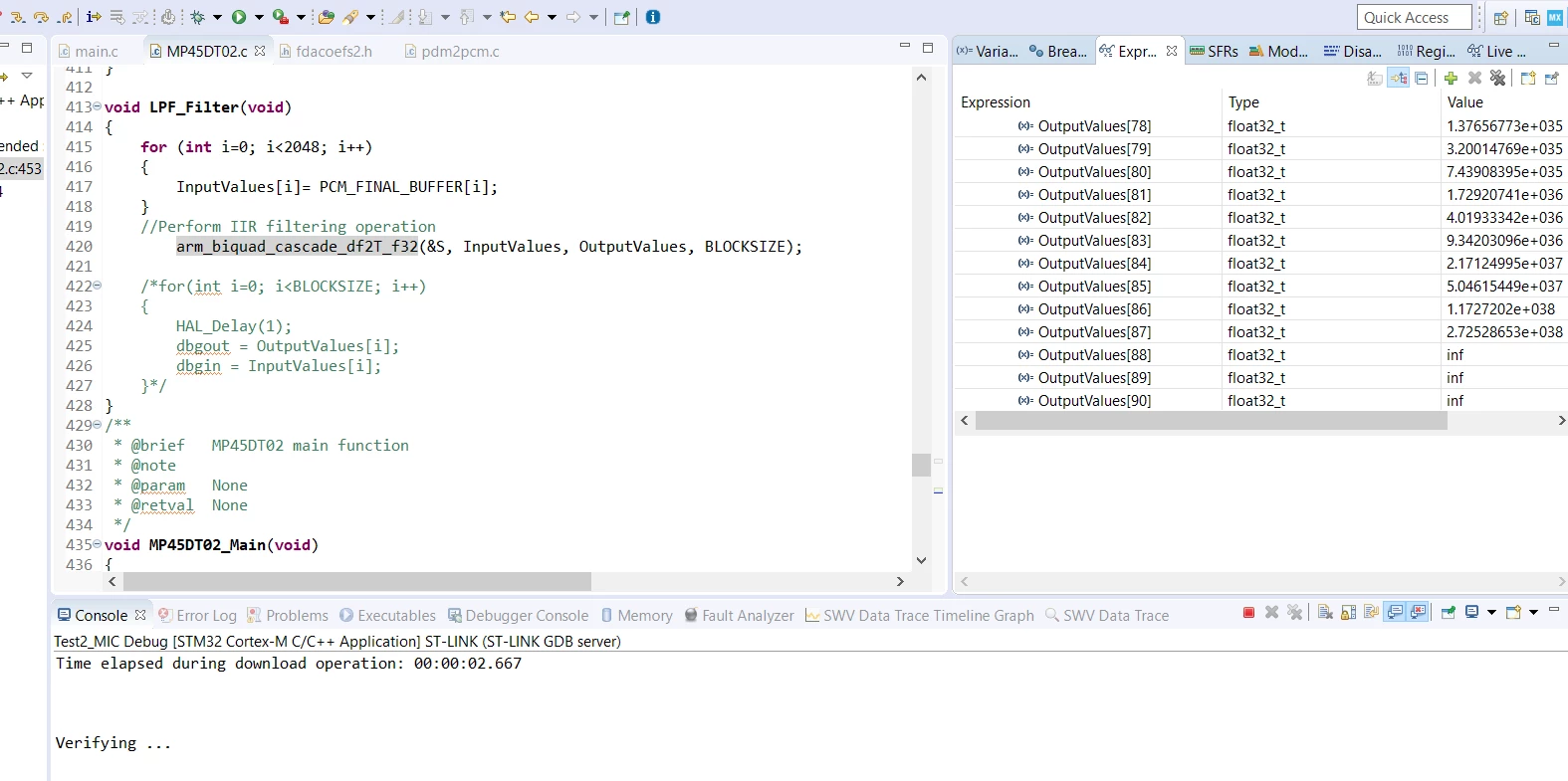

Hi all,
I am developing an IIR filter with CMSIS-DSP but it gives wrong output data mostly (inf) , even that the data is correctly acquired, I test FFT and it's work great!
Any help will be appreciated.
Thanks in advance.
0693W000005BPLfQAO.png0693W000005BPLkQAO.png0693W000005BPLzQAO.png0693W000005BPM4QAO.png

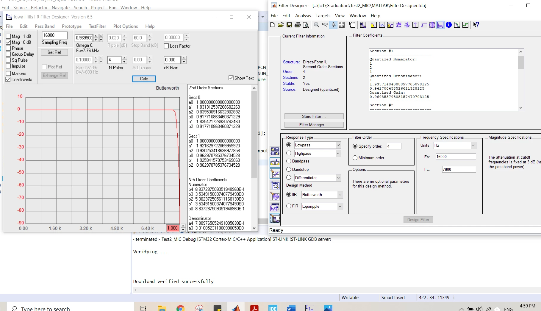

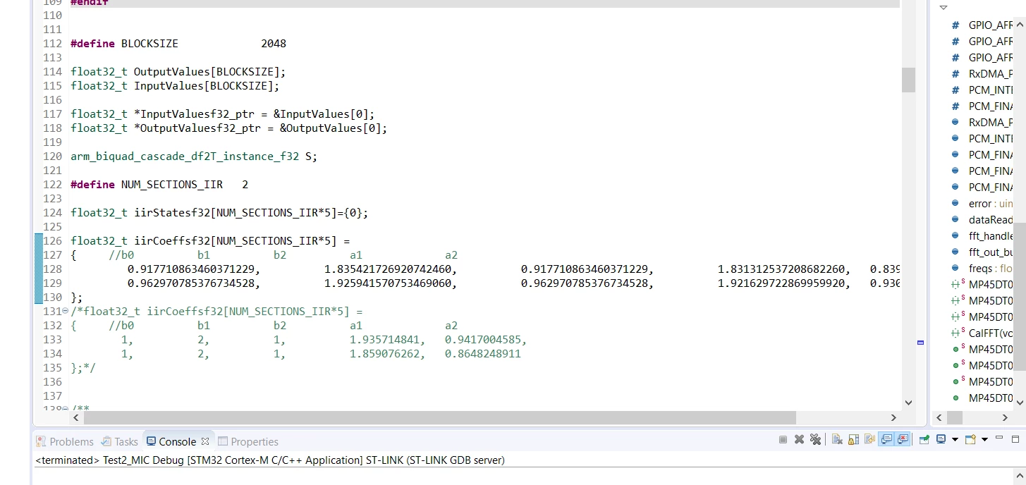

I just flip a1 and a2 coefficients sign, just as simple as that! Actually, it took a lot of my time:grinning_face_with_sweat: hope to save other people time
The same thing in MATLAB and lowa Hills IIR filter designer tool.
