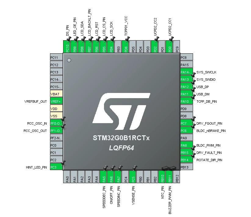

If I want to use UCPD2 in STM32G0B1RCT6, is HSI16 the only choice as the driving clock for this integrated PD controller? May i use HSE?
In my application, UCPD2 will be active for USB type C PD Sink (45W), which will be working together with other peripherals, such as timers, USB(DEVICE), etc.
 0693W00000HoVNTQA3.pngIf the driving clock for UCPD2 is HSI16(in datasheet described), if no other choice, that means i have to use the HSI clock source for the whole projects. That means there are no chance to choose HSE. Is that correct?
But actually, PD is only a part of the system, not the whole in my application. Could you please gibe me some suggestions?

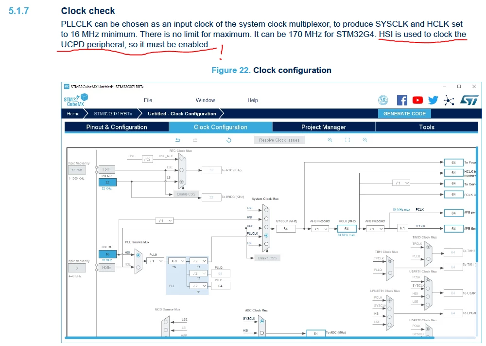

Lmatt.11
Lmatt.11Author
Dec 14, 2021 9:11 AM UTC
@Peter,
Thanks a lot for your info..
I also saw this, that means the HSI must be enable, if not the PD controller will not work normally.
0693W00000HoVyPQAV.png I worried about the stability when the HSI running in high temperature, for example nearby the higher limit of range(-40°C to 85°C/105°C/125°C, the operating temperture for STM32g0b1rc). For the device may work in a high temperature circumstance.
But have no choice, hope it's superfluous:smiling_face_with_smiling_eyes:.
