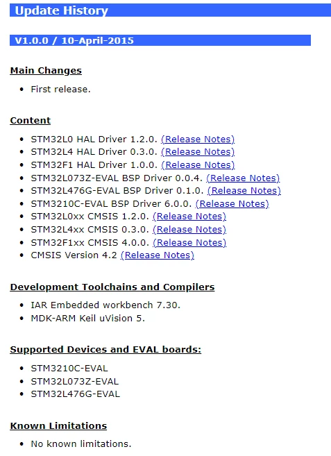

Then, I checked the possible IAP implementation and I reached the AN4657, but it seems quite old and without CubeIDE examples or latest STM32 MCU families implemented:
  1. Is there any update for STM32U5 IAP examples?
As last result, I got the IAP_main and IAP_binary_template example for STM32U575 (mine is STM32U5A5) , but the second, as a template, is quite empty, the first is quite good example, using UART and SDD memory and ThreadX and FileX middleware.
  1. Is this the best example to follow for OTA FW upgrade with LTE modem and Flash SPI memory? Do I need any warning?

Personally I think the IAP process/model would be the way to go.
Perhaps with the cellular modem downloading via FTP or HTTP using it's own implementation and staging on its own file system NAND, and the recovering that with the STM32 and rewriting FLASH.
Harder path is using modems Socket interface to pull data from a server manually and write FLASH directly, without staging.
