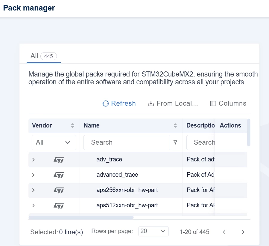

Aug 13, 2026 14:25 UTC
Hi ​@gil_dobjanschi
First, under Pack Manager you can manage the global packs required for STM32CubeMX2, and select .pack from local path
