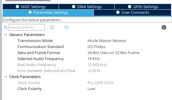

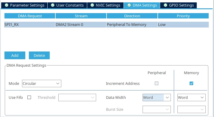

I have NUCLEO-F756ZG board with STM32F765ZG and I have hooked up ICS43434 mic into I2S1 bus. Now I have been scratching my head for a day to figure out how to get data out from that puppy. Or actually getting data out is simple, but to make it sane is not. I have configured I2S and DMA like below
Then I allocate some buffers and write DMA callbacks and send the data to freeRTOS task for processing. Now if I play 1kHz sound and dump the raw data from DMA buffers I get something like this
113,58880,0,0,116,43008,0,0,123,4608,0,0,134,42496,0,0
If I draw the 113, 166 so every 4th sample to graph it is the sine wave what I am playing. My friend the AI said that the data format is left_high, left_low, right_high, righ_low. That might very well be, but I don't want that. If the mic sends 24 bit of data in 32 bit frames it feels insane that I have to spend 2*32bits of memory for it.
I just can't figure out what am I missing. It does not help HAL_I2S_Receive_DMA is one big red herring, but I believe it probably isn't the problem. I did try to configure DMA to half word in hope to get the 24 bits into 2*16bit, but that didn't fly. I might have missed something in this though.

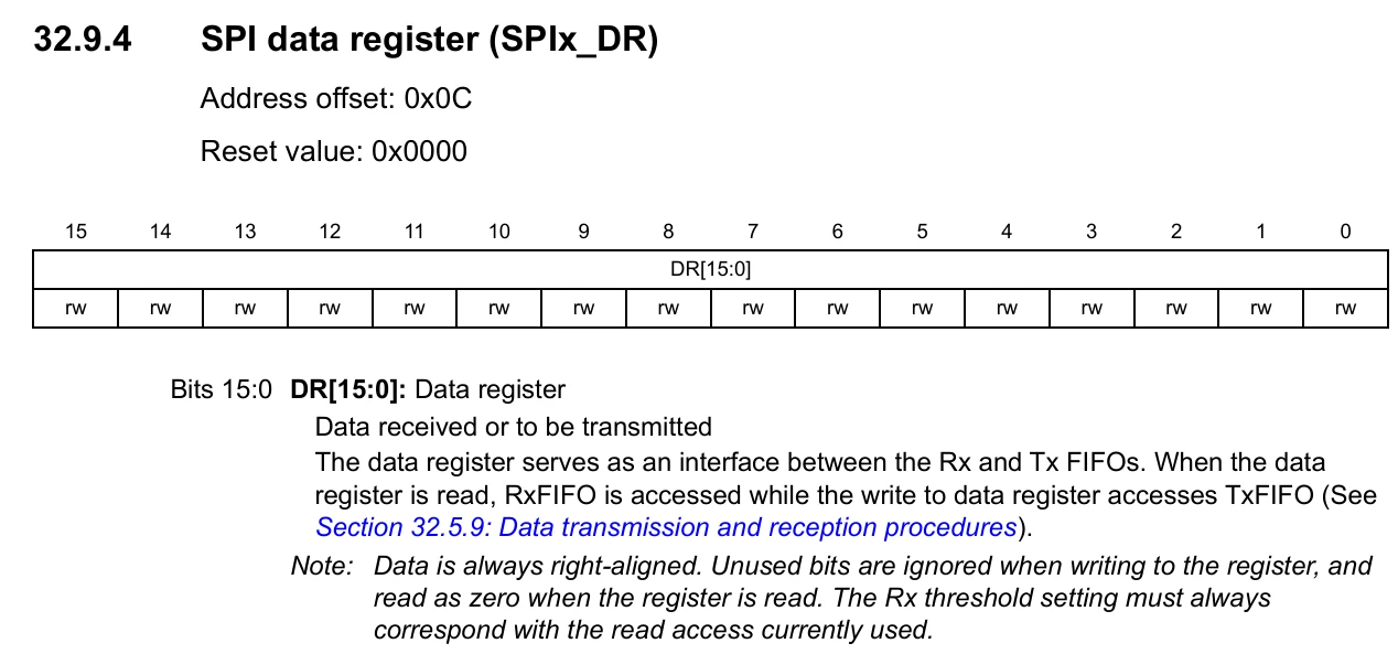

The DMA should be set up for half-word access on the peripheral side since the DR register is 16-bits.
You can keep the memory side at 32 bits, but the bytes might not be in the right order.
When it's set up as a word, it's reading 32 bits but only half of them are relevant, so you're getting double the data.
Explain what is not flying.

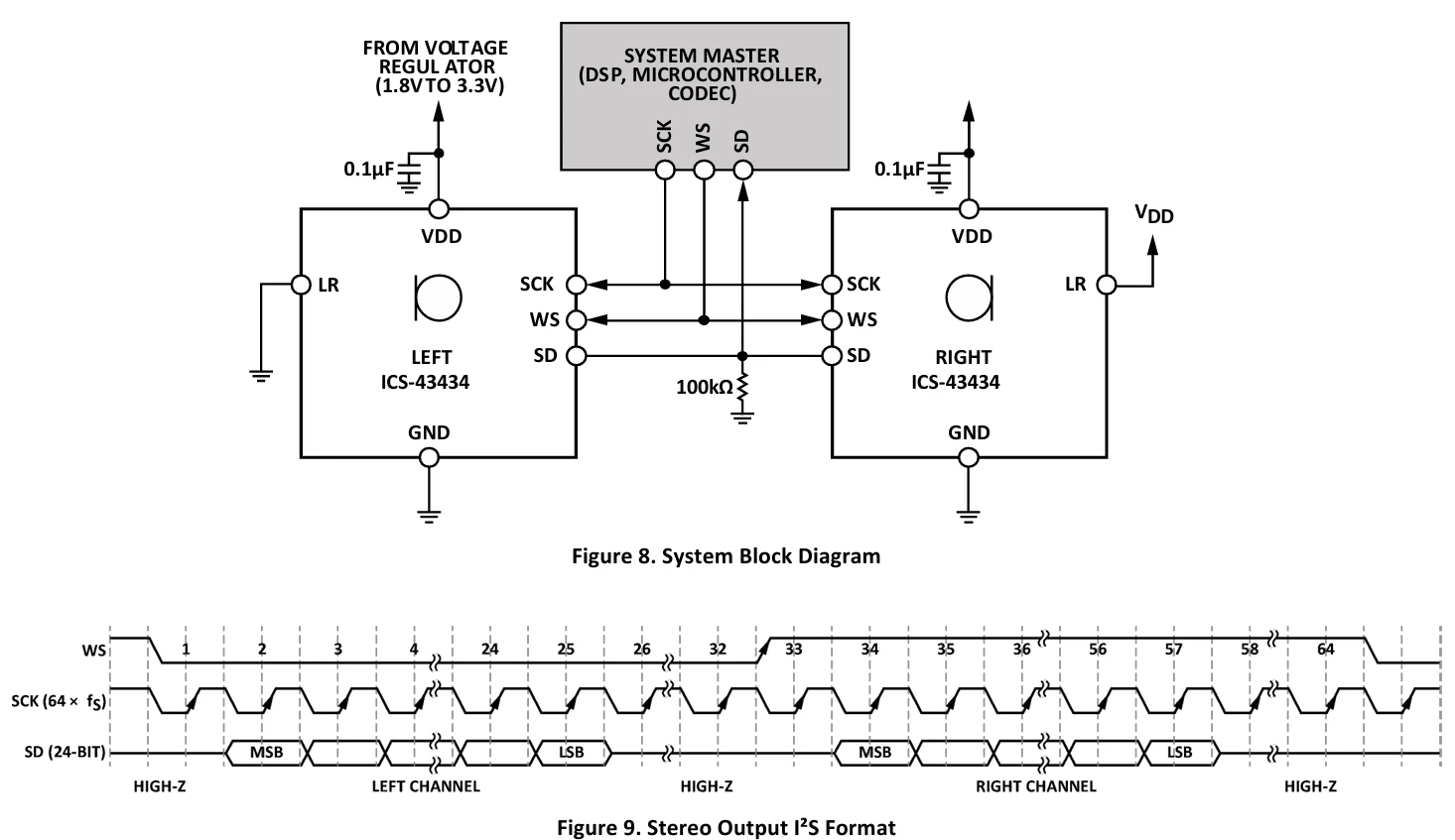

Hello @JusbeR

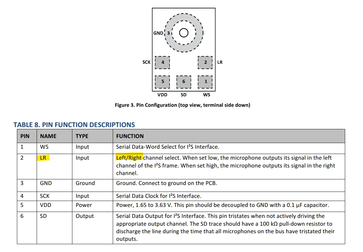

The microphone you are using is mono with output in sterio format.
According to the datasheet we have a pin LR that should be set to select the output on the right or the left chanel.
So it is normal that you receive the half of data as 0.

Looks like these are meant to be in stereo, with one device outputting on the left channel, and the other on the right channel. With only one device, half of the data will be 0, as you see.
If you only have one device, you could set it up to output on the left channel and use SPI to read it instead and use WS as the CS signal. Don't think there's an I2S setting to ignore half of the data or capture "mono" audio.

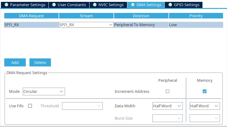

May 12, 2025 7:18 AM UTC
All right. I think I got it now by combining all the hints you guys gave me. The final clue was @TDKs half word hint. So the culprit was
- Use half word DMA setting even if you use word memory block
- Swap the half words (as in not Little/Big endian swap, just swap the half words)
- Give HAL_I2S_Receive_DMA the actual count of words in the buf not half words
Here some screenshots and code for future reference
static inline int raw_to_sample(uint32_t dma_raw) {
 return ((dma_raw & 0xFFFF) << 8) | (dma_raw >> 24);
static uint32_t dmabuf[128]
HAL_I2S_Receive_DMA(h, (uint16_t *)dmabuf, 128);
This way you when you get the half full interrupt you will have data in 0-63 where left in even and right in odd numbers. After full interrupt data is on 64-127.
