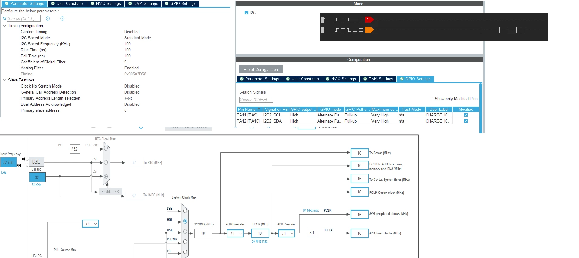

Hi experts:
    I’m working on NUCLEO-G031K8 trying to use its I2C2(I2C1 is OK),I set PA11/PA12 as SCL/SDA, pull-up, OD, when I tried to read data, I found SCL is always high, but SDA has datas, I can’t figure out what’s missing, can you help me with that?

  1. Don’t rely on the MCU-internal pull-ups for I2C - use real resistors close to the MCU’s SCL and SDA pins.  4K7 or 10K should be fine for 100kHz or less and normal (on-board) distances.
  2. Verify the pin configuration - you certainly don’t need a “very high” rate in the settings.
  3. Confirm that the SCL and SDA pins aren’t connected to something else on the Nucleo.
  4. Andrew always (with good reason!) wants to see a photo of your setup.
Jul 9, 2026 01:29 UTC
It looks like you are using a sampling rate that is too slow to see what is on the line. Perhaps use an analog capture. Show wiring. Ensure you are actually monitoring the pin you think you are. Toggle the pin as a GPIO output and view on the scope to verify that it can be toggled and is not shorted high.

I am thinking about the PA11(PA9) .
is there anything on PA9? Is PA9 an outputpin?
i can’t get an schematic of this nucleo board.
But on L412KC we have to remove two jumpers on the board to get it work with
SPI and I²C
just my 2 cent

The schematic schows no link between PA9 and PA11.
I wonder whats the PA11(PA9) in the GPIO settings…

Please use the configuration below in your code :
    __HAL_RCC_GPIOA_CLK_ENABLE();
/**I2C1 GPIO Configuration
PA11 ------> I2C1_SCL
PA12 ------> I2C1_SDA
GPIO_InitStruct.Pin = GPIO_PIN_11|GPIO_PIN_12;
GPIO_InitStruct.Mode = GPIO_MODE_AF_OD;
GPIO_InitStruct.Pull = GPIO_PULLUP;
GPIO_InitStruct.Alternate = GPIO_AF6_I2C2;
HAL_GPIO_Init(GPIOA, &GPIO_InitStruct);
/* Peripheral clock enable */
__HAL_RCC_I2C2_CLK_ENABLE();
In order to give better visibility on the answered topics, please click on 'Best answer' on the reply which solved your issue or answered your question. Saket_Om

Once again, DON”T USE THE INTERNAL PULLUPS FOR I2C.
​@TDK
​@lbapplem Indeed - which was the initial problem here:

Use external pullups! like 3k3 on the lines as David told you.
