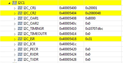

I have experienced a wrong behavior of the I2C driver of STM32H743ZI MCU (Nucleo board).
What's happening? The driver is simply dividing by 2 the slave address passed as a parameter to the function HAL_I2C_Master_Transmit. This leads to an absence of communication between master and slave (which is here an aardvark I2C SPI adapter), since master is transmitting to an erroneous slave address.

In the attached document scope_KO_I2C_slave_adr_0x48.bmp, you can see the transmitted slave address on the SDA that I captured with an oscilloscope. Instead of having bin1001000 as expected, we are reading bin0100100. This is actually the slave address shifted right, so it is divided by two.
Furthermore, I inspected the register where slave address is configured (I2C_CR2). The last byte of this register is dedicated to Slave address. As you can see in the attached register dump document register I2C.png , the correct slave address is written to the register (0x48). Somehow, the CPU divides this address by two afterward.
A simple correction for a developer is to multiply by two the desired slave address, before calling any HAL_I2C_*** function.

But here the register description of I2C_CR2 is quite clear, I think:
Bits 7:1 SADD[7:1]: Slave address bit 7:1 (master mode)
In 7-bit addressing mode (ADD10 = 0):
These bits should be written with the 7-bit slave address to be sent
So your 7-bit I2C address must be shifted left one position. Always beware of this confusion when people are talking about I2C addresses. If only the Phillips guys would have used the MSB for R/W ...

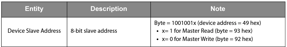

Dec 12, 2022 3:30 PM UTC
@Andreas Bolsch​ so, in this case I'm gonna shift the address 0x49 to the left and forget about the "x" ? I've got a 7+1 address sensor.0693W00000WKo0nQAD.png

Dec 12, 2022 4:16 PM UTC
Correct, you use 0x92, and the I2C peripheral controller deals with the -R/W bit based on the interaction you're engaging in.
You can tell if something is on the bus because it will ACK to it's address.
