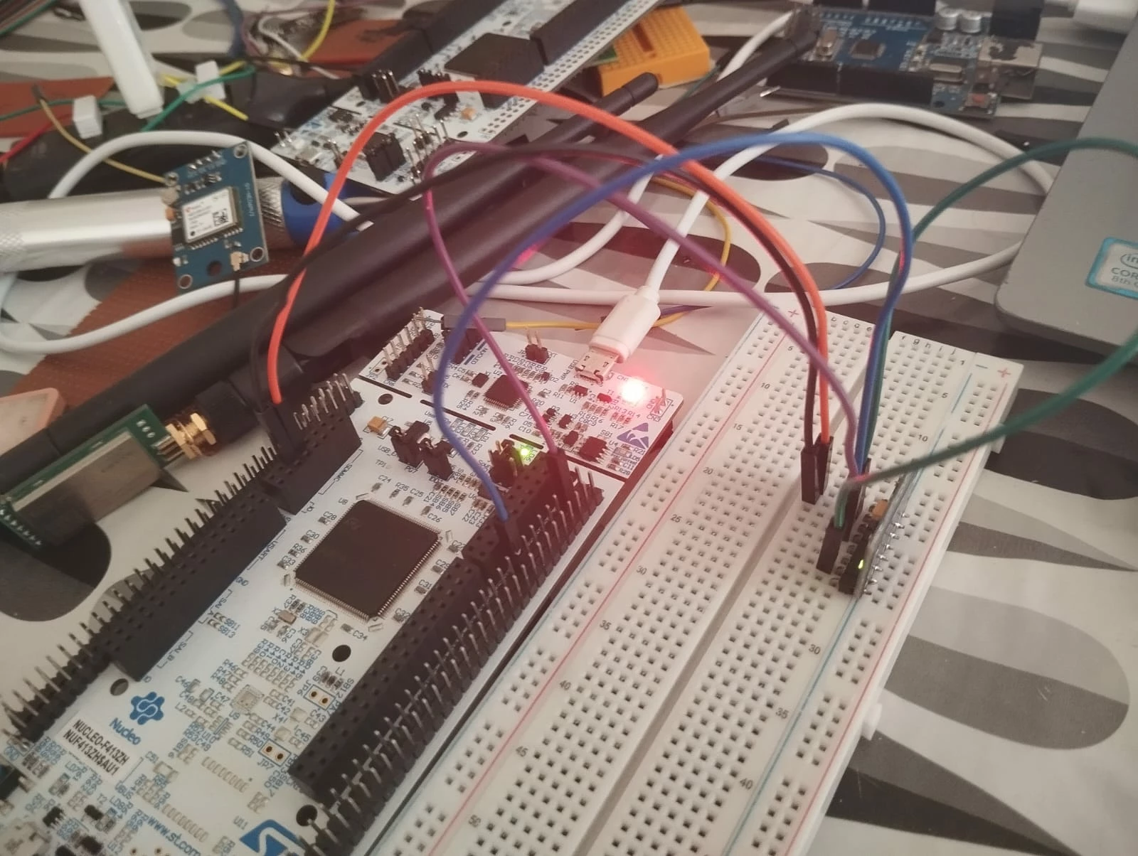

Andrew Neil
August 1, 2024
This seems like a continuation of this thread:
https://community.st.com/t5/stm32-mcus-embedded-software/stm32-i2c-not-working-with-other-interrupts/td-p/703781
Did you ever observe what's happening on the I2C lines - with an oscilloscope ?
As @TDK said in that thread, the HAL_BUSY return likely means that one/both line(s) is being held low - you would be able to see that on an oscilloscope.

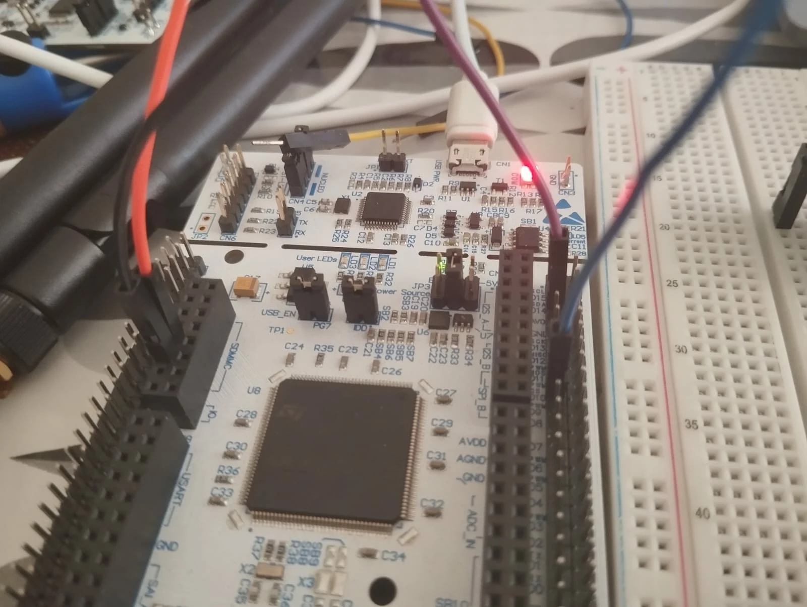

I can't see that you ever confirmed what board you're using - was @Dazai correct in assuming NUCLEO-F413ZH ?
How is your I2C slave connected to the board? long trailing wires? breadboard? other??
Some good, clear photos of your setup would help.

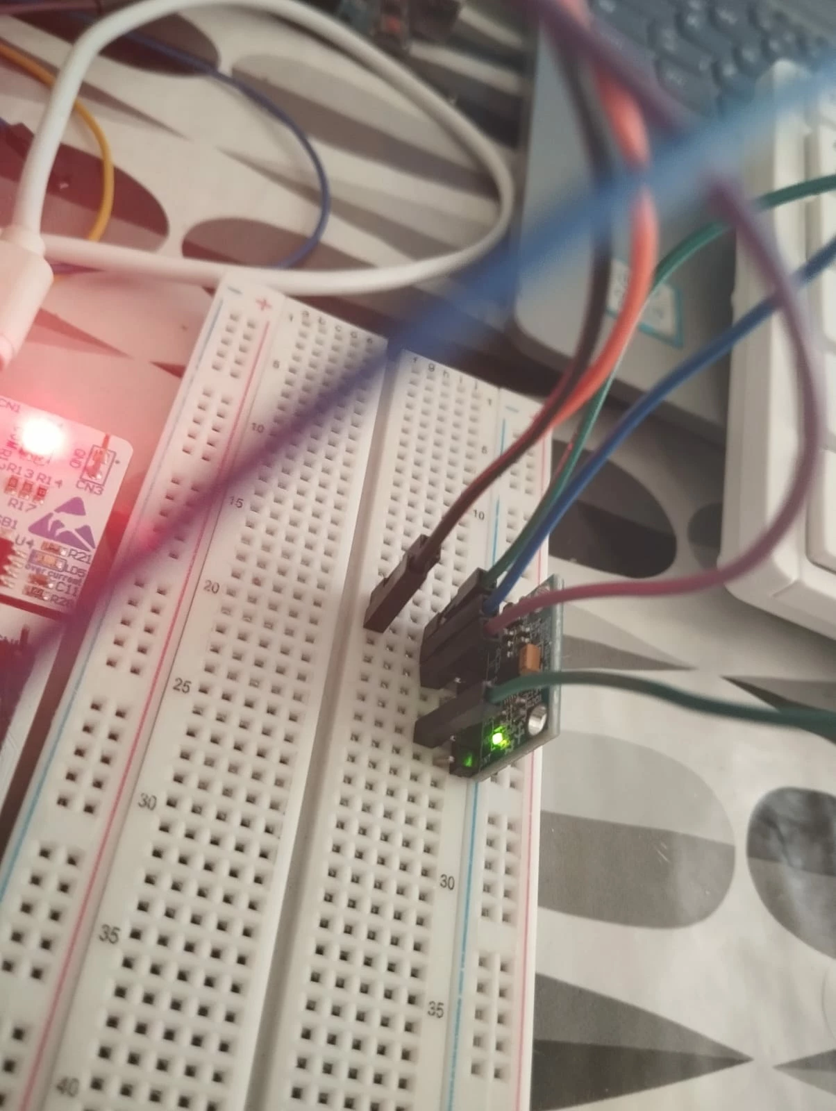

Hi Andrew, first of all, thank you. Yes, the problem continued, but I think I have solved the problem now. I am leaving the code below that I left above. When I added this code, everything got better. Probably the reason for the error was that, as you said, the scl and sda lines did not start as they should. I will leave the code and picture below and the card I use is stm32f413zh.

WhatsApp Image 2024-08-01 at 5.15.28 PM.jpegWhatsApp Image 2024-08-01 at 5.15.29 PM.jpegWhatsApp Image 2024-08-01 at 5.15.f28 PM.jpeg
