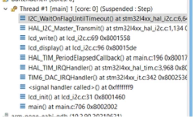

I2C_WaitOnFlagUntilTimeout, TIM16, I2C, Servo, HAL_GetTick()

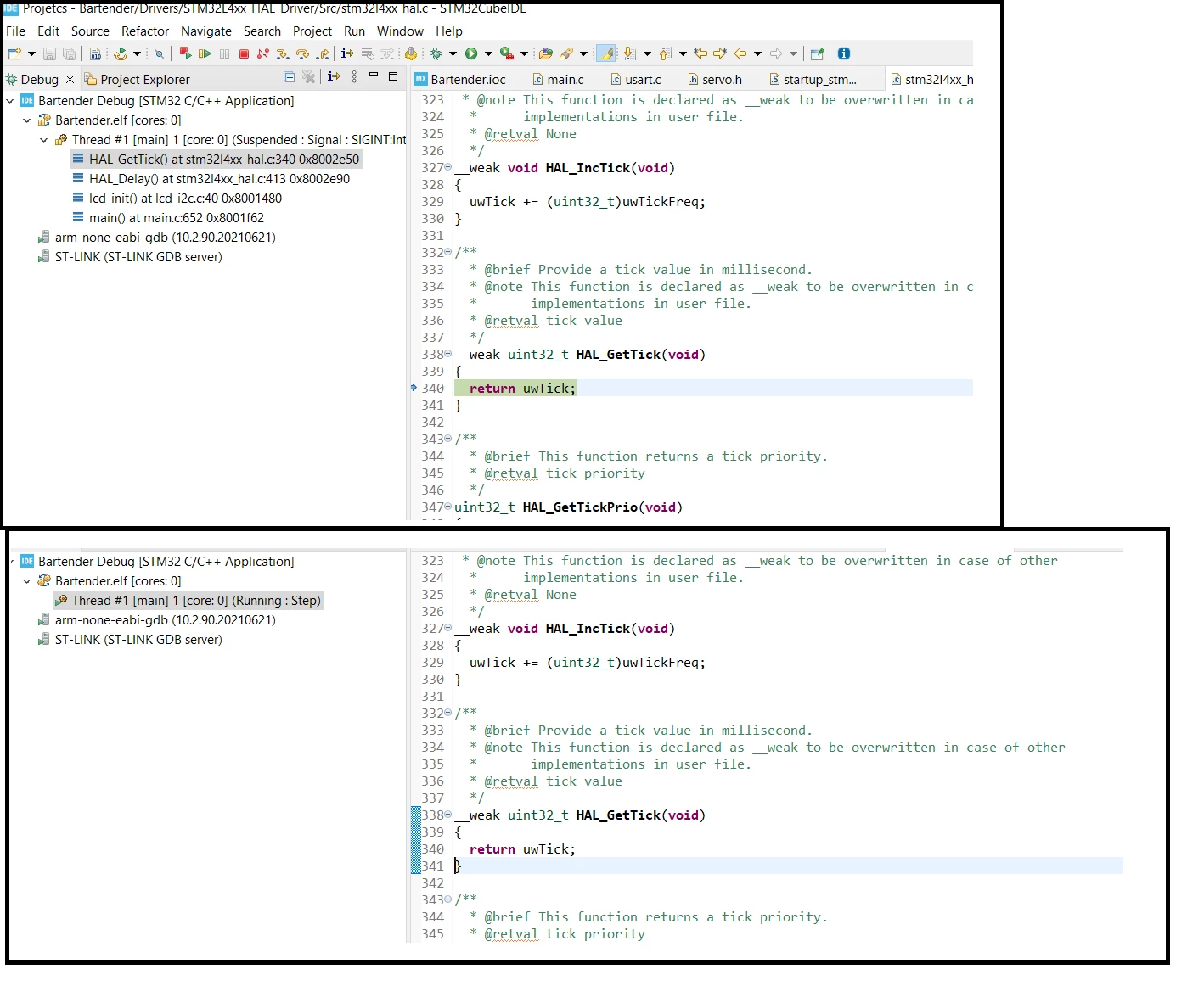

I added a TIM16 to the project with interrupts to handle the servo

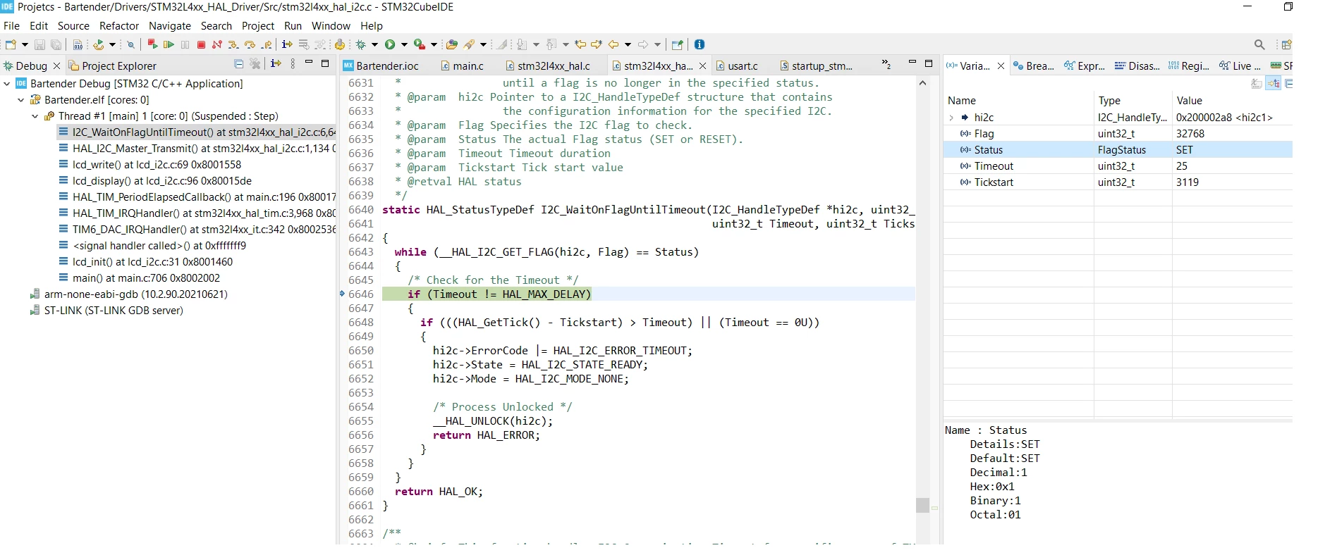

Unfortunately, after adding it, the program started to crash
Below are screenshots of where it started to crash
Does anyone know how to fix this?

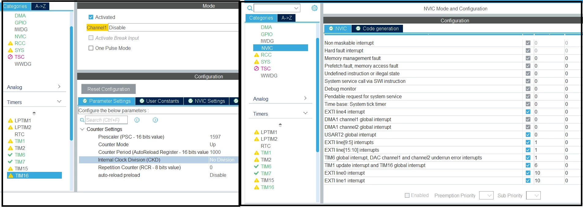

This is how I configured TIM16:

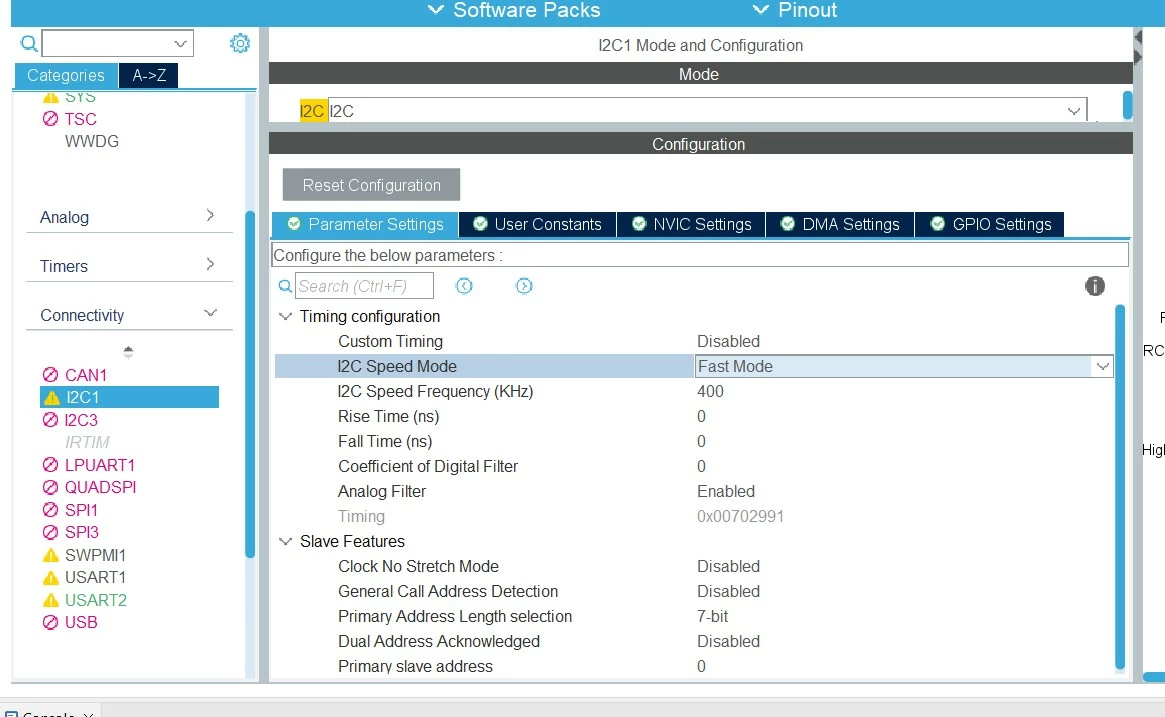

this is an i2c configuration:
TDKBest answer
Dec 27, 2023 9:59 PM UTC

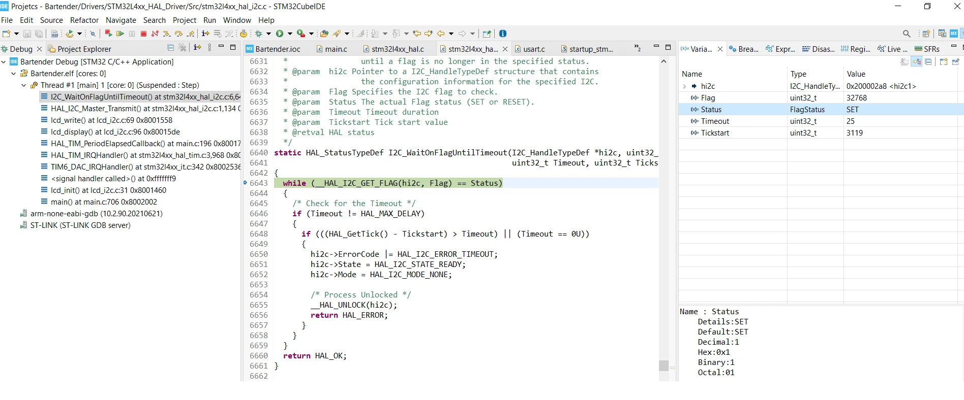

Your call stack suggests you're calling lcd functions within an interrupt handler, which isn't ideal, but without first calling lcd_init. Doesn't appear to be related to TIM16.
Initialize the lcd before using it. Try to avoid blocking calls within an interrupt context. It can work, but you need systick to have higher priority than what you're currently in.

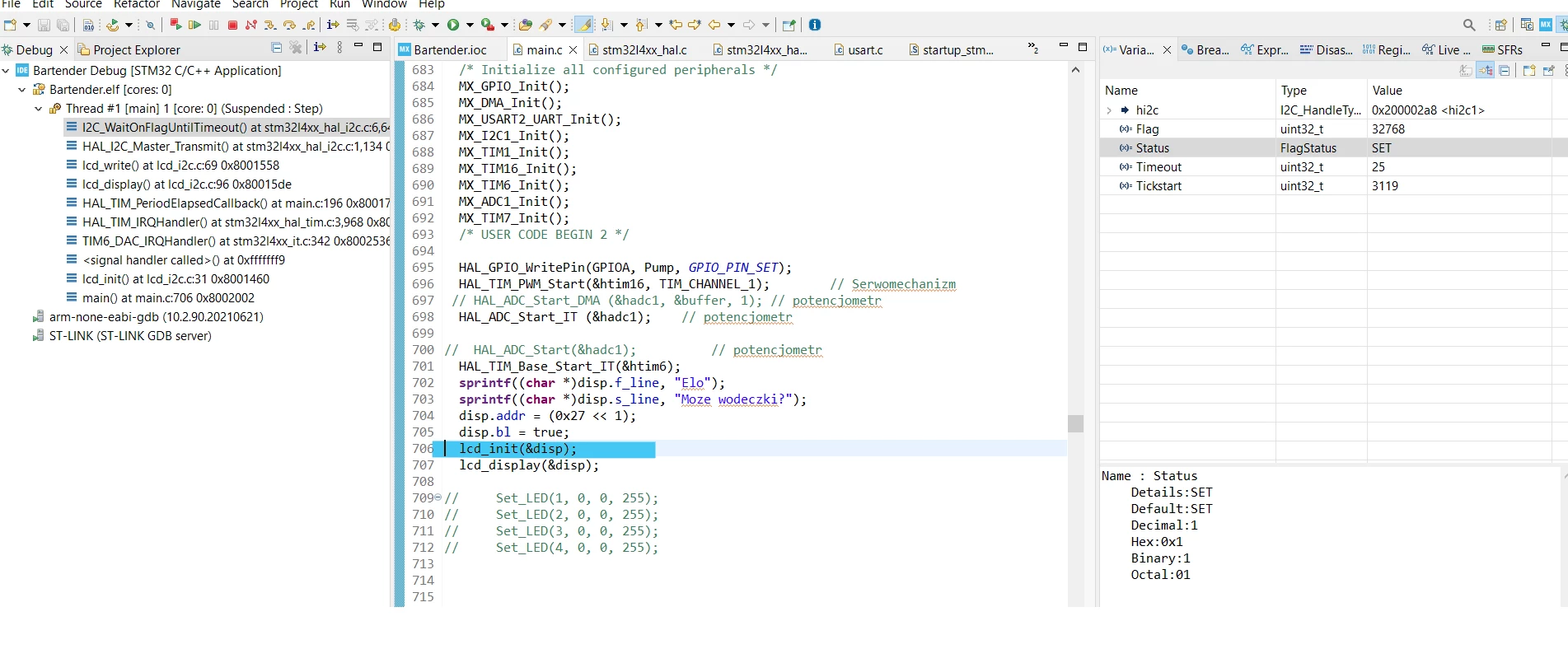

grzeniuxAuthor
Dec 27, 2023 10:28 PM UTC

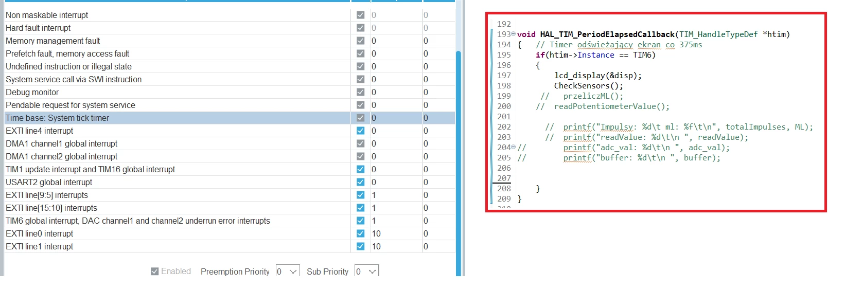

"Doesn't appear to be related to TIM16." - However, when I turn it off, everything works
"systick to have higher priority" - zero is the highest priority? I have set 0
"Your call stack suggests you're calling lcd functions within an interrupt handler," - I use this to refresh LCDs, it seemed the most effective option to me

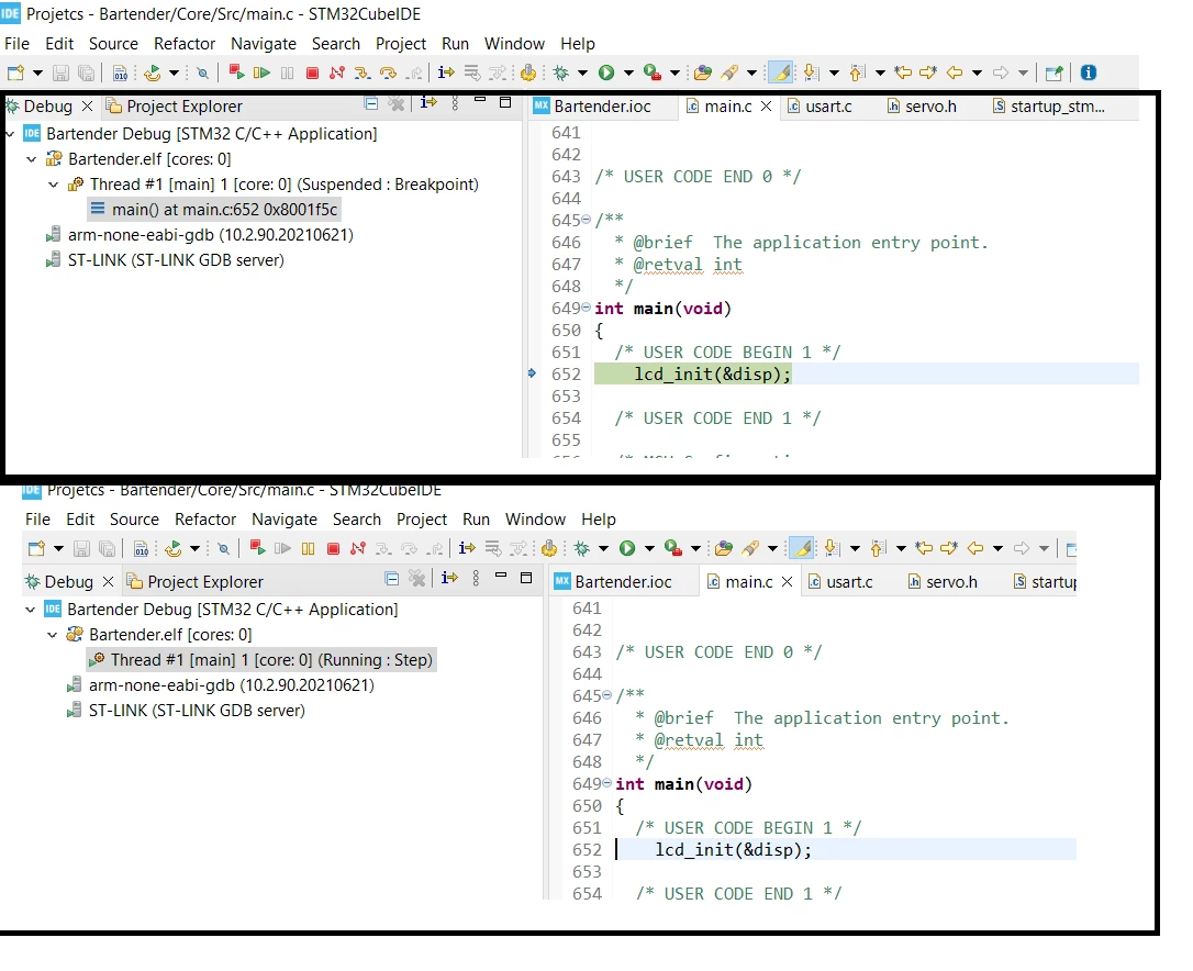

int main(void)
  /* USER CODE BEGIN 1 */
lcd_init(&disp);
  /* USER CODE END 1 */
  HAL_Init();
  /* USER CODE BEGIN Init */
  HAL_GPIO_WritePin(GPIOB, Pump, GPIO_PIN_SET);
  /* USER CODE END Init */
  SystemClock_Config();
  /* USER CODE BEGIN SysInit */
  /* USER CODE END SysInit */
  MX_GPIO_Init();
  MX_DMA_Init();
  MX_USART2_UART_Init();
  MX_I2C1_Init();
  MX_TIM1_Init();
  MX_TIM6_Init();
  MX_ADC1_Init();
  MX_TIM7_Init();
  MX_TIM16_Init();
  /* USER CODE BEGIN 2 */
  HAL_GPIO_WritePin(GPIOA, Pump, GPIO_PIN_SET);
  HAL_TIM_PWM_Start(&htim16, TIM_CHANNEL_1); // Serwomechanizm
 // HAL_ADC_Start_DMA (&hadc1, &buffer, 1); // potencjometr
  HAL_ADC_Start_IT (&hadc1); // potencjometr
//  HAL_ADC_Start(&hadc1); // potencjometr
  HAL_TIM_Base_Start_IT(&htim6);
  sprintf((char *)disp.f_line, "Elo");
  sprintf((char *)disp.s_line, "Moze wodeczki?");
  disp.addr = (0x27 << 1);
  disp.bl = true;
  lcd_display(&disp);
when I placed: lcd_init(&disp); at the beginning of the maina, other errors appeared
Jnevi.1
Dec 27, 2023 11:11 PM UTC
you mentioned tim16. in your irq handler you refer to tim6? is this correct?
and you should not put your display init routine at the very beginning because then your spi/i2c/whatever your type of display is won't be initialized at that time. so after your pheripherals init but before the timers are started
in your irq handler you should only set some flag and update your display in the main loop. doing display update stuff in your irq handler may be an option but normaly is bad as TDK mentioned

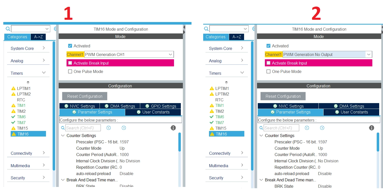

grzeniuxAuthor
Dec 27, 2023 11:55 PM UTC
"you mentioned tim16. in your irq handler you refer to tim6? is this correct?"
I used the TIM6 as a timer to refresh the LCD and to check whether the tap switches were pressed. - but I understand that this is not correct
I use the TIM16 for servo operation
Here a simple example:
// htim16.Instance->CCR1 = 25; // 0 degree
// HAL_Delay(2000);
// htim16.Instance->CCR1 = 50; // 45 degree
// HAL_Delay(2000);
// htim16.Instance->CCR1 = 75; // 90 degree
// HAL_Delay(2000);
// htim16.Instance->CCR1 = 110; // 153 degree
// HAL_Delay(2000);
// htim16.Instance->CCR1 = 125; // 180 degree
// HAL_Delay(5000);
When I have option 1, the display does not show anything, it is blank, even though debugging everything goes on
When I have option 2, the display works normally
If I understand correctly, it is like switching the TIM16 on and off (options 1 and 2)
So there is a connection with the TIM16
Do you have any ideas gentlemen?
Dec 28, 2023 12:43 AM UTC
Be a little more systematic than turning a knob and seeing if it works or not. Look at the stack trace, understand what is happening. Realize that trying to use the LCD prior to it being initialized isn't likely to work well.
So correct them. If you need help, post your modified code and related errors.
