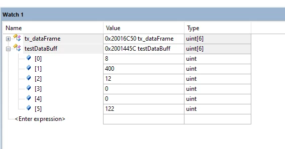

I have implemented a basic I2C between STM32H7 (Main) and STM32F4 (Secondary) processor. I am using an array of size 6 to transmit from the Main CPU to Secondary CPU using I2C in IT mode.
The HAL API for I2C requires the data_buffers to be of size uint8_t, but the HAL APIs also accept data_buffers of size uint32_t if they are typecasted to uint8_t.
The next parameter for the data buffer size should be unt16_t for which I have implemented them as: size(txData)/sizeof(txData[0]) and the same implementation for the rxDataBuff on the receiving end.

What I noticed is, if I initialize my "TxDataFrame" and "rx_dataFrame" as an array of 'uin8_t', then the HAL APIs for I2C are able to successfully transmit and receive the complete data of the array.
But, if I initialize my "TxDataFrame" and "rx_dataFrame" as an array of 'uin32_t', type cast the data buffers inside the HAL API as an "uint8_t", then the secondary CPU experiences data loss. In my case, the value stored in the last index position of the rx_dataFrame is lost.
For instance,
On the MAIN CPU:
uint32_t TxDataFrame[6]  = {8,642,0,0,0,138};
HAL_I2C_Master_Seq_Transmit_IT(&hi2c1, SlaveAddress << 1,(uint8_t *)TxDataFrame, Size_TxD, I2C_FIRST_AND_LAST_FRAME);
On the Secondary CPU:
uint32_t rx_dataFrame [6] = {0};
HAL_I2C_Slave_Seq_Receive_IT(&hi2c1,(uint8_t *)rx_dataFrame,(uint16_t)rxDataFrame_Size,I2C_FIRST_FRAME);
If I load the TxBuff with another set of random data, then the RxBuff is loaded with data upto index position 1 (RxBuff[0], RxBuff[1]), while the remaining array is all 0s.
UPDATE: Resolved issue for 32 bit data handling on I2C using HAL API.
The fix to the size thing was simple and with the help of @Bob S I was able to implement the correct size for the buffers.
The HAL APIs should be implemented in such a way when typecasting 32 bit buffer to an 8 bit for I2C.
MAIN Processor:
HAL_I2C_Master_Seq_Transmit_IT(&hi2c1, SlaveAddress << 1,(uint8_t *)TxDataFrame, Size_TxD * sizeof(uint32_t), I2C_FIRST_AND_LAST_FRAME);
SECONDARY Processor:
HAL_I2C_Slave_Seq_Receive_IT(&hi2c1,(uint8_t *)rx_dataFrame, RXBUFFERSIZE * sizeof(uint32_t), I2C_FIRST_FRAME);
This correct implementation made my data transfer successful using the HAL API.

What are the values of Size_TxD and rxDataFrame_Size?  If your buffers are 6-element arrays of uint32_t then those should be (6*sizeof(uint_t)) = 24, because I2C transfers are ALWAYS number of BYTES.
