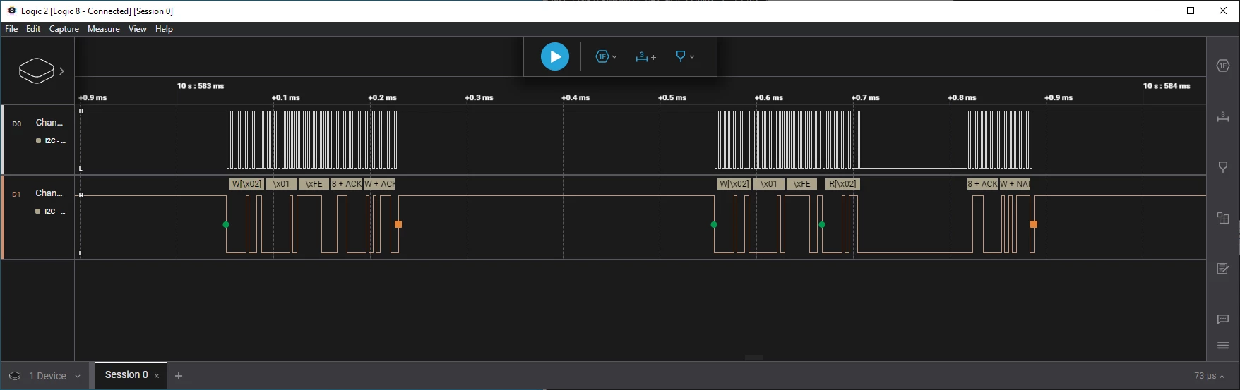

For the configuration I am using CubeMX and most of the time the slave is working quite fine. However sometimes (1 in 100), the slave transmit count (how many bytes have been read by the master) is not correct (one off - although the master reads the correct amount of data (see analyzer picture))

When the slave is sending data, the master is the receiver and the master is the one ACKing or NACKing data to indicate the end of the transfer.
In your plot, I see a write of 4 bytes, then a write of 2 bytes with a repeated start and a read of 2 bytes (with a clock stretch duration), the last of which is NACKd. I'm not sure what this is supposed to show or what is wrong/unexpected about it. Should the master have received more than 2 bytes? or does the slave think it send more/less?

The picture shows that on the scope everything looks fine (also for the master). In the second frame the master reads 2 bytes from the slave but the slave_tx_cnt variable indicates that only one byte has been read, which is wrong.
But this only happens 1 in 100 times that the slave_tx_cnt is off by one (too small).
Is the way how the slave_tx_cnt is calculated correct (line 20)? Why do I need the -1? (I put it there otherwise the slave_tx_cnt will bee too big 99 times out of 100)
