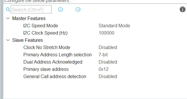

I am currently working on a project where I need to configure a NUCLEO F411RE Board as an I2C slave. It will be connected to a Raspberry Pi Master.
I am able to detect the NUCLEO on the raspberry Pi, however I am unsure how to get the read byte. I created a simple code where when the byte received is 0x01 or 0x10 the LED should turn on, if it receives anything else it turns off. However this doesn't seem to be working.
This is the code I am using:
uint8_t buffer[0];
for (;;)
HAL_I2C_Slave_Receive(&hi2c1, (uint8_t *)buffer, sizeof(buffer), HAL_MAX_DELAY);
if ((*buffer == 0x01)|| (*buffer == 0x10)){
HAL_GPIO_WritePin (GPIOA, GPIO_PIN_5, GPIO_PIN_SET);
HAL_Delay (100);
else{
HAL_GPIO_WritePin (GPIOA, GPIO_PIN_5, GPIO_PIN_RESET);
HAL_Delay (100);
If anyone can help me with this issue, it would be greatly appreciated. (I am sending a 0x01 on the Raspberry Pi side)

daeAuthor
Feb 7, 2024 10:04 AM UTC
I am using a basic I2C Configuration as seen in this screenshot. The connection to the Raspberry Pi is simply wires connecting SDA, SCL and GND Pins. The Raspberry Pi has its own pull up resistors.
I will check out the example provided, thank you!
mƎALLEm
Feb 7, 2024 10:10 AM UTC
You need to check the wire continuity between the two boards (SDA, SCL and GND) , it could be also something related to the wires themselves ..
